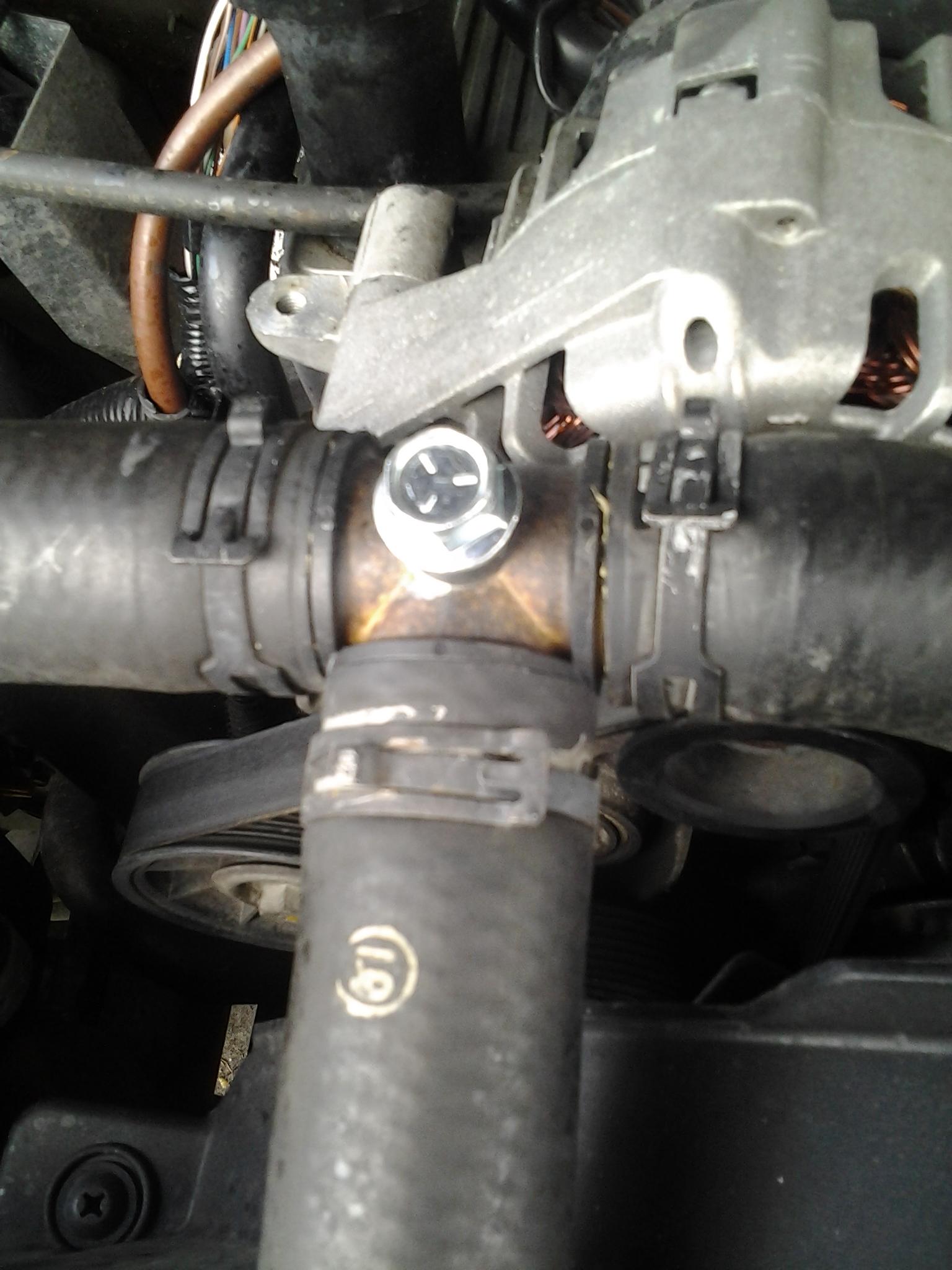

Obviously we all know this is plastic and it ... corrodes. I knew this and ordered the bolt and it cost $11 or so I was a bit mortified by the price but knew it had to be done.
Next day I went to check my fluids and noticed my coolant was low (again) so letting the car idle and watching I noticed it was coming from the bleeder screw while examining I touched it and it..fell off :eek:
I took a flat head screwdriver and lodged it into the remaining plastic and unscrewed it. So obviously with 3-4 business days until the bolt comes in I needed SOMETHING, I took a look in a bin of random stuff and a friend realized a 3-way cable splitter end fits perfectly.
Off to the hardware store (in a different vehicle obviously) and $0.88 later a 3/8" bolt is in and no more leaking :D Not sure how well this will hold up but for those not wanting to spend 12$ on a bolt or who are putting off changing that out this should be a good warning.

JaySun Mar 16, 2014 01:55 PM
1 Attachment(s)
Originally Posted by bosshogt (Post 453091)
I ordered 2 brass ones(one to look at on the parts shelf), kept the spare plastic one in the onboard part store in the cargo bin,for any buddy on the trail or side of the the road I could roll up and be hero for the day.
You sir are a gentleman and a scholar, hopefully there's more like you.
Also this is how it turned out
Attachment 56957
