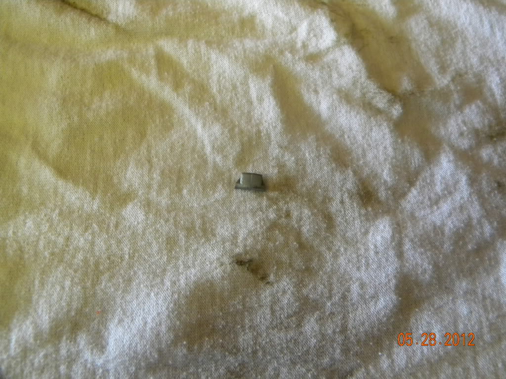

Further inspection i noticed a piece missing (directly over the cable).
Attachment 43099
I found this inside the mirror. It looks like it broke. :(
Attachment 43100
