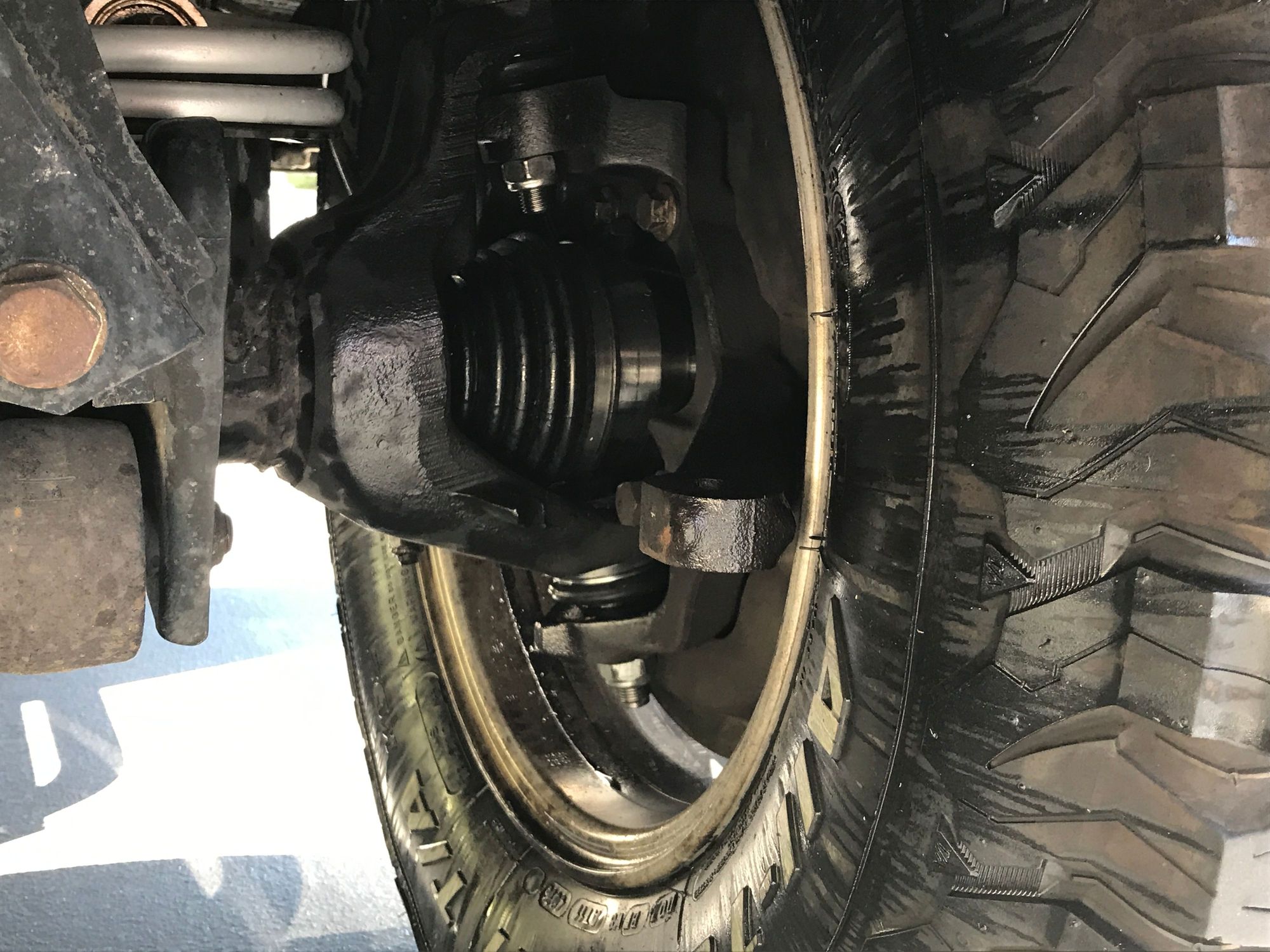

I’ve heard many horror stories about front axle seals going from perfectly fine to leaking like a fire hose almost over night. I can attest to this from personal experience.
Two weekends ago I installed new axles, hubs, rotors, and calipers at all four corners (photos in the “What did you do” sticky thread). On the passenger side, a seal that was leaking miraculously sealed itself and stoped leaking with the new axle, but on the drivers side, a seal that was perfectly fine decided to give up the ghost (even though I was very careful inserting the new axle, used lots of diff oil for lubrication, etc).
Anyway, read all the stories of guys going through two, sometimes three seals on a single axle before getting the leak to stop. Some say avoid ****Part, others say go OEM only, still others say it doesn’t matter as everything is aftermarket now anyway.
Picked some on eBay, rolled the dice, and installed the new seal on the drivers side on Sunday. Bought two and was going to do both sides, but as a now well-seasoned Rover owner, I opted to leave the now non-leaking passenger side alone (if it ain’t leaking, don’t touch it). So far, after 200+ miles, both sides are looking good, even after topping up the front diff.
https://cimg4.ibsrv.net/gimg/landrov...d5fa23505.jpeg
Drivers side seal leaking and throwing oil everywhere.
https://cimg5.ibsrv.net/gimg/landrov...abe07972f.jpeg
Drivers side tire. Pulled both wheels off to clean them but only replaced drivers side seal.
https://cimg6.ibsrv.net/gimg/landrov...761475287.jpeg
Drivers side post seal replacement.
https://cimg7.ibsrv.net/gimg/landrov...a7e2183ed.jpeg
Passenger side. Still not leaking again.
