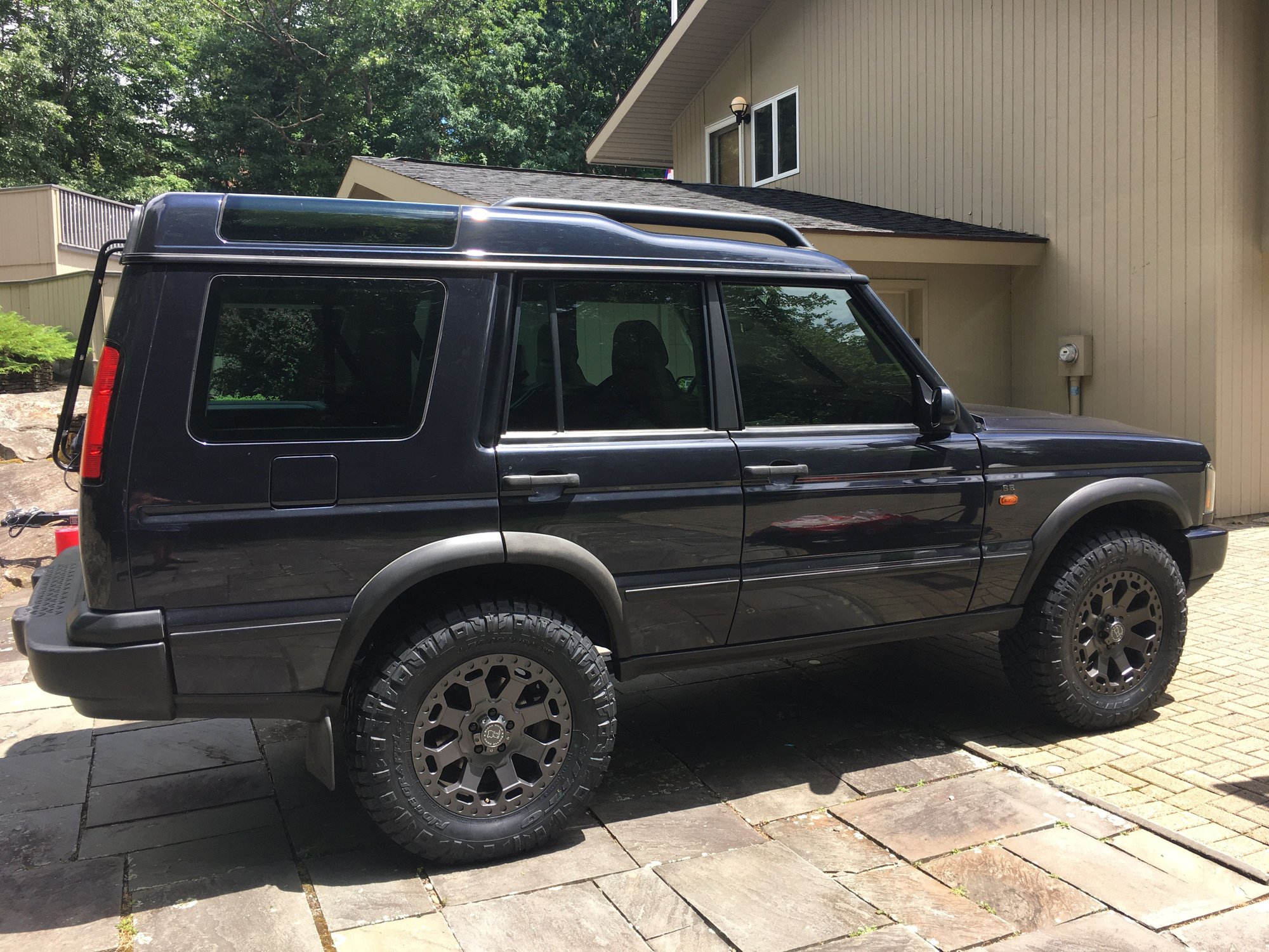

glopez2k Jul 1, 2020 03:07 PM
So? any solution to this small challenge? I have the very same issue, only a slight rub, I don't want to open the turn radius. Has anybody trimmed just a bit off the wheel well at the lower plastic? Any pics? Thanks!
ahab Jul 1, 2020 08:19 PM
My truck has the same size tires in question here and rubs ever so slightly at full lock. Not sure which side or where it's rubbing but the driver's side has a very strange cutout at the bottom of the leading edge of the wheel lip. It doesn't even look like the tire would rub there if it wasn't cut, (plus it still does) so I"m not sure what the deal is but I can take some pics of it tomorrow.
glopez2k Jul 1, 2020 09:24 PM
https://cimg2.ibsrv.net/gimg/landrov...918ca5945.jpeg
This is the setup
https://cimg6.ibsrv.net/gimg/landrov...e5db17f55.jpeg
This is where the front driver’s side tire rubs the plastic bottom of the bumper. Thinking about cutting a bit off
