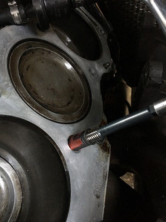

So i figured id share my experience with stripped head bolts last week. After blowing #4 I tore the engine down. In the process i ordered TTY bolts. After finding several bolts "finger tight" i knew i had a thread problem and after much research ordered studs. I ordered both kits the Buick and the "new" longer ARP stud kit for comparison. I read many times there are no differences in length and that is incorrect. I did not take the time for official measurements but its in the 1/4 to 3/16 area and i wanted the extra threads. After much research i ordered time serts. Actually a harley davidson thread repair kit. 7/16 14 1" long insert. Some one had installed a helicoil previously and stripped it out. I special ordered a 1.5" from bel-metric who are awesome by the way. I trimmed maybe an 1/8" off the longer insert to go full depth in the stripped helicoil hole. After it was all said and done i installed the heads and started the torque sequence. Pulled two more studs one at 40 ft lbs and one at 70. Pulled the heads installed inserts and stopped at 60 ft lbs this time. My back ground it 5.0 mustangs and the older ones only needed 65 ft lbs on cast iron heads and block. I think 70 is sketchy and the 100 arp recommends is ludicrous. Any way hope this helps some one down the road.

Motorhead1 Feb 7, 2017 11:46 AM
Can you post part #'s?
gulfdisco Feb 7, 2017 01:08 PM
157-4301 correct studs
124-4003 Buick studs
Time-Sert kit 0761E
