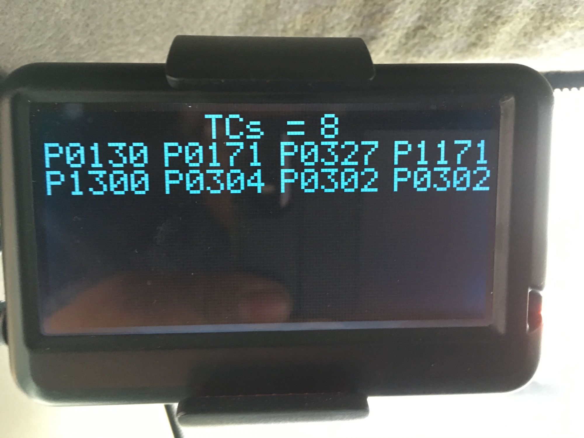

LR03NJ Dec 9, 2016 06:34 PM
You figure this out!
Originally Posted by TRIARII (Post 587596)
During engine swap the heads from my old block were machined at local machine shop. Front 02 sensors were replaced with Bosch. Then one failed so I replaced again with another Bosch. Rear 02 sensors are proline. In my experience faulty O2 sensors trigger a lean O2 related trouble code. Ive had them in the past but all were resolved once sensors were replaced.
Codes:
P0305= cylinder 5 misfire
P0306= cylinder 6 misfire
P0303= cylinder 3 misfire
P0300= random multiple cylinder misfire
The cats do not glow red. The CEL does not flash. Engine temps do not exceed 209 (average 197-203). No apparent fuel odor or fuel leaks. No visiable coolant leaks.
According to datastream
Fuel trim a = 1.00 :1
Fuel trim b = 100 :1
Idel air = 100.96 kg/h
https://cimg8.ibsrv.net/gimg/landrov...b890d64c6a.jpgThis are the codes im having the day before I had my inspection. I replaced my bank 1 O2 sensor then drove 46 miles start and stop, had inspection following day ( fingers crossed all the way ) PASSED! No codes until now.
Im just saying, this might help you figure out with this codes otherwise a miracle happened to me. LOL!
