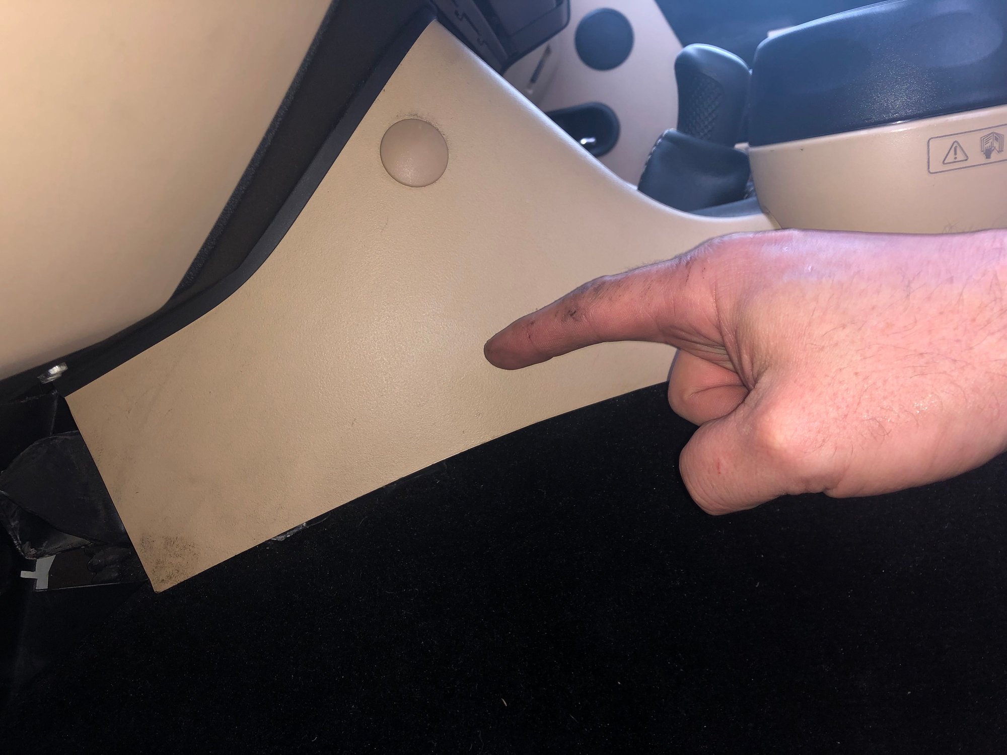

My key started getting weird so I replaced it with a push button start. I got the RF ID type so I hid the sensor in the center counsel right next to where my knee sits. It is a stand alone system so it doesn’t effect my keyless entry at all. I’ve had it on my other Rover for a while and it worked great. Plus I like the look of the push button. I didn’t want to mess with my existing ignition so I simply removed it. So I can put it back in if I ever want. The only down side is there is no longer a steering wheel lock.

There here is a round sensor that you will need to hide. To Activate the system you have to touch the blue ref tag to the sensor. I put this in the center counsel. On my other Rover I put it in the plastic under the steering wheel. Either place works quite well.
