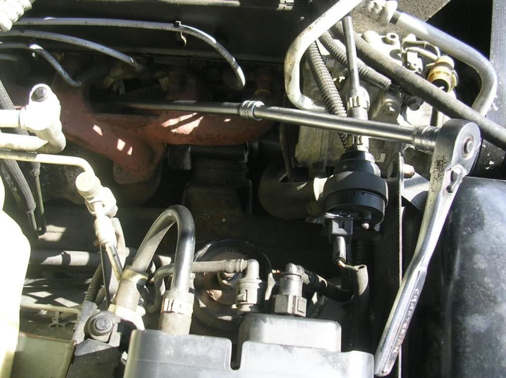

1 Attachment(s)
On the D2, 8mm inside hex/allen on the top bolt. I just did this and I think I used the extensions in this order from the bolt head up, but not 100% sure.
8mm hex drive bit socket -> 3" ext. -> universal (stiffer is better) -> 6" ext -> 3/8" ratchet. I directed the sockets down between the pipes and toward the bolt, then took my hand to put the hex in the bolt head. Carefully grabbed the ratchet and kept pressure to keep it in the bolt head, and then loosened it slowly.
You can use an additional 6" ext. at the top end to get you up away from the manifold pipes, but I found I could get more torque on it with just the one 6" extension and coming up in the middle of the manifold between the 2nd and 3rd pipes.
You definitely want to clean the crude out of the top bolt head first (PB Buster) and at the same time soak that bolt overnight may not hurt, depending on how much oil is on/around your parts. Same bolt size inside hex bolt on the bottom.
There is also a shallow bolt head on the motor mount flange to on the front of the engine that holds the heat shield on, 10 mm I think. Nice pic of this in RAVE to locate this bolt head. You will need to hold it snug to keep the socket on while taking it off or it will slip off the bolt head. I have not put this back on, just let the spring-clip on the heat shield hold it in place on the starter itself after replacement.
You had to work with the heat shield to get around it. I ended up bending it a bit to get it out, and just bent it a little at a time to put it back in to get back to the original shape in regard to the 90 degree angle for the mounting point to the motor mount.
The nut on the battery cable on the top of the starter is 13mm.
Below pic from a D1, but same idea on a D2.
http://s291.photobucket.com/albums/ll290/phototferg/Attachment 43794
