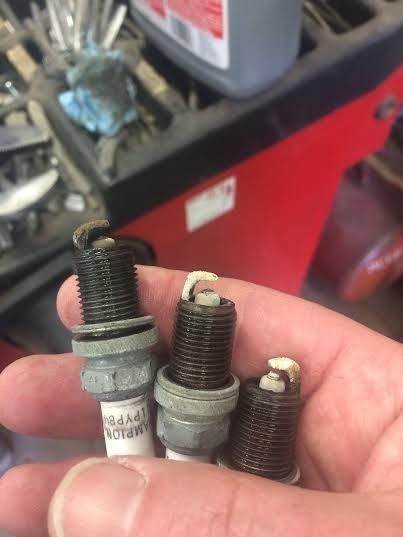

Jmcbghs2012 Mar 9, 2016 07:14 PM
Update: Sorry it took me so long to reply..The land rover had a compression test today and the results came back okay... told me that it needs both coils and upper intake gasket. I attached a picture of the old spark plugs..not sure how many miles are on them but know at least 30k
