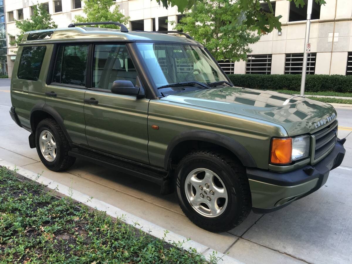

Hey folks. I just got my first D2. I’m stationed overseas, and she’s happily sitting at my sisters house for now. It’s a very clean and straight 2000, in Kent Green. It’s got TF springs and shocks, but stock size 16” tires. I’m assuming Medium duty because it doesn’t appear to be lifted in the photos I have.

Judging by the pictures, I would guess you have 1-1.5" of lift at least.
