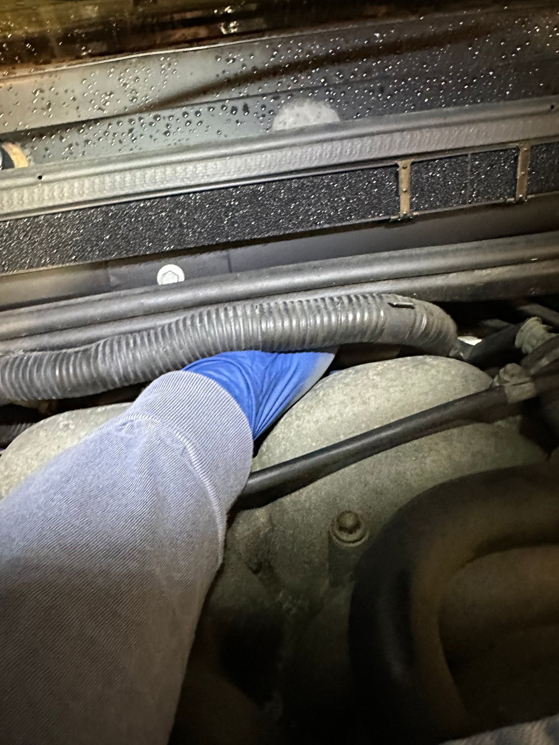

Since this is the first result in Google, and there aren’t any real photos elsewhere, here is how to find it for others who end up searching like I did:
Climb on top of your cold engine, and shove/smash/reach your left hand behind the right side of the intake manifold. You’ll feel a metal tube with threads pointing rearwards:

Extinct Feb 11, 2025 03:44 PM
I could have sworn I posted a pic of this before
https://cimg7.ibsrv.net/gimg/landrov...ab42195a00.png

whowa004 Feb 12, 2025 10:29 AM
it's truly in a terrible spot for diagnosing. Just glad there is one, pre 95 classics do not and have to cut fuel line to test pressure..
