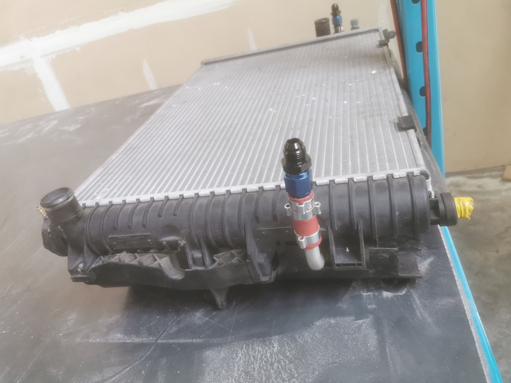

604x4BC May 8, 2021 12:21 PM
Franken Radiator complete.
This took a while to sort out, and what I've done I think should be temporary...I will figure out an option for a AN threaded cooler in the future.
Compression Fittings did not work, bad idea. I had to sand the tubes, which took forever...and then I guess they were too thin and the compression fitting crushed the tubing.
Ended up chopping that part off and joining a AN hose barb fitting to the cooler with a piece of hose sufficient for the fluid. Bunch o clamps to hold it together. Looks awful, but hopefully it works out for a while.
