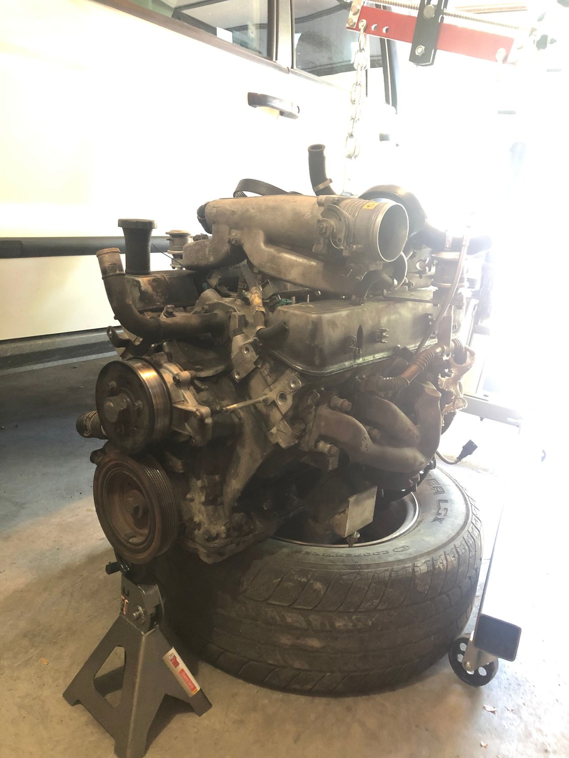

Excited! today after work, I'll pull the headless LR 4.6 out of the Rover and get it set aside. I'll probably heat the block, press the sleeves and see if I can have the block repaired and then rebuild the whole thing and sell it to someone who'd like a 4.6 that is freshly rebuilt for something cheap.

Old 4.6L with overheating issues

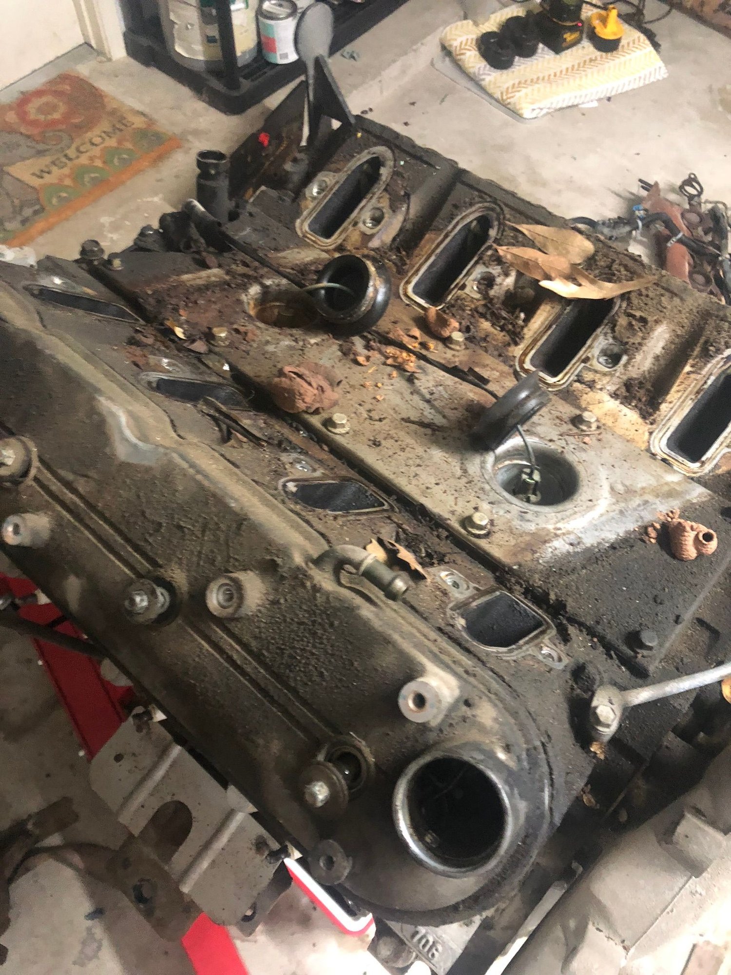

https://cimg4.ibsrv.net/gimg/landrov...b152accc56.jpg
Well. My engine is out, now I'm just cleaning the engine bay of grease and prepping for the new motor. I figured this is the time to address anything I don't love about the engine bay. Ready for kit to be on sale!!!!!!
Meanwhile:
-Clean engine bay
-Consider new gasket between T-case and tranny as it seems to be leaking (maybe not worth the trouble)
-Consider drive shaft upgrade or at least build a guard for the tranny in case the drive shaft fails though it seems fine now
-Look into lifting a couple inches (needed for swap anyway)
-Find 16" set of tires to be winter/off-road tires and keep the 18's for summer street performance tires
I may push the sleeve out of this motor and see if the block can be fixed, if so then I'll consider putting this motor together and selling it someone who wants a 4.6 with only 94k miles on it that can't drop sleeves. I'd only do this if it looks as though the block is otherwise not going to repeat the issue. I already have access to new rebuilt heads for $260 from a local fella to go with it if so.
