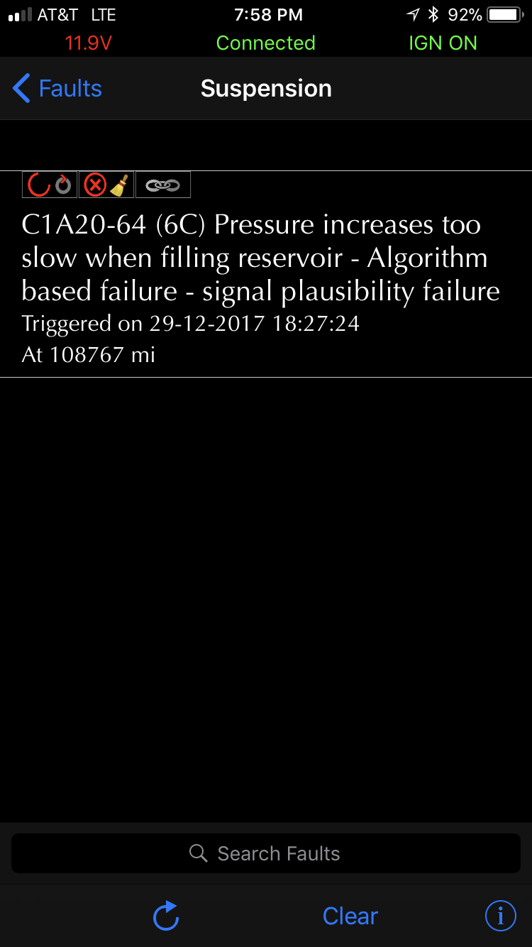

I don’t have a tool for reading codes.
This is a pic I got off the Internet, but it’s the same as what I’m seeing.

schwaggy Jan 17, 2018 07:32 PM
My guess is it's the same as my '09 is currently throwing, intermittently. Started over the Christmas holiday when I was high in the Sierras and it was cold. Been happening every few days ever since. My Hitachi compressor is original so going on 9 years or so. I assume the deep cold finally put the system over the edge.
I have parts ready to replace it with a new AMK, only need the time. I know you can work on the dryer of these compressors that may fix this issue, but with one that old forget it - replace the whole unit.
