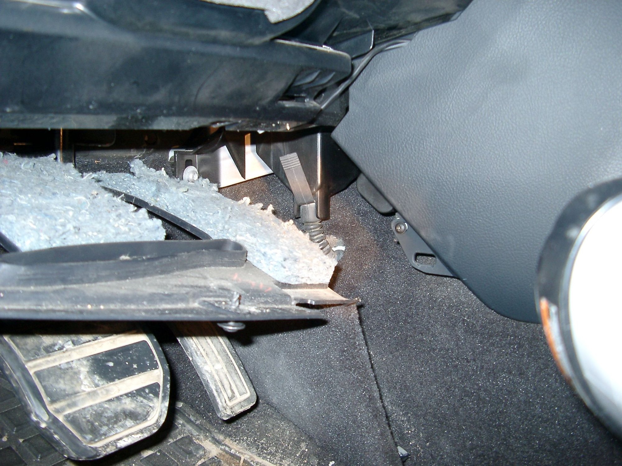

bbyer Mar 11, 2025 06:06 PM
Two sources of water.
The front carpet can get wet for two reasons - plugged sunroof drains and it sounds like you have solved that.
The sunroof drains tend to get the carpet wet near the door sills as the door sills "overflow". As you know, the real bad news is that the wires under the door sill then start to corrode. That usually shows up as door locks that will not function or those under door courtesy lamps or the ones in the door buttons - they do not illuminate.
The second is wet carpet near the transmission tunnel on one or both sides. That is water from disconnected or plugged the HVAC drains, one on each side of the transmission tunnel per the jpg.
If that area is wet, the source of water is either from the operation of the air conditioner - condensed water that is supposed to drain thru the floorpan onto the ground or rainwater off the windscreen that is also supposed to drain thru the floorpan. The jpg shows the plastic nipple connected to the thru the floor drain rubber extension. There should be no need to block off the big windscreen air/water inlet per the previous jpg.
The two HVAC drains are supposed to handle any amount of water coming in assuming they are connected and not plugged. Actually the water usually drains onto the skid pan, hence one does not see it on the ground as with the rear HVAC drain.
Re the dash speedo cluster, there is one big connector feeding into the rear of the cluster. The cable is a bit too short from the factory and hence tends to not fully insert or sort of pulls out and hence parts of the display do not display. Also within the cluster, there is a backup chip that has the vehicle serial number imprinted in the software. What I am saying is that usually one cannot just swap in a junkyard cluster due to VIN mismatch. It requires some sort of computer program to mate differing clusters.
https://cimg3.ibsrv.net/gimg/landrov...219ae8a30b.jpg
