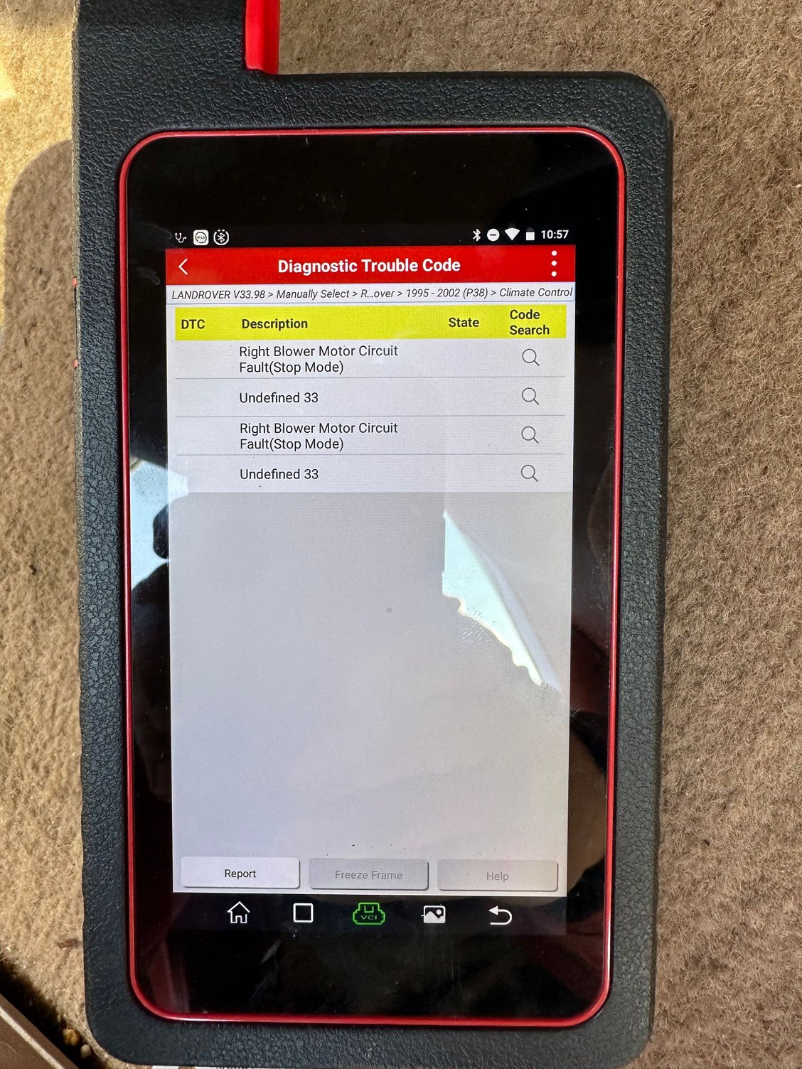

So here is what I got to start with and what I have showing for codes that stay
https://cimg0.ibsrv.net/gimg/landrov...269f5d9a6.jpeg
https://cimg5.ibsrv.net/gimg/landrov...fa037ff25.jpeg
So learned folks of the P38 aside from the dead blower motor what thoughts do you have on chasing this down

ArmyRover Feb 26, 2025 04:34 PM
The second pic with the blower motor and code 33 is what comes back everything else seems to be working

Alright so I tore into the center stack on the P38 and got the old control unit out. To be honest this was just a guess as I really had nothing pointing at the HEVAC unit being the problem. So I got it swapped in fired up the truck checked the codes and saw all the same data. Then it dawned on me I hadn’t cleared anything. So I cleared it and heard the compressor kick to life under the hood. So I hooked up the gauges and put some more Freon in the system and we have cold AC. I didn’t fully charge the system so I can check pressure this evening and see if it’s holding. If it is full charge and moving on. That just leaves the right hand blower motor I think to have what we need working!
ArmyRover Apr 7, 2025 10:11 AM
Right hand resistor pack appears to be bad and that is what is keeping the fan from running. I’m leaning towards skipping the fan speed control and just putting the switched 12v straight to it which would in theory run the fan at full speed whenever the fan is turned on by the control unit.
