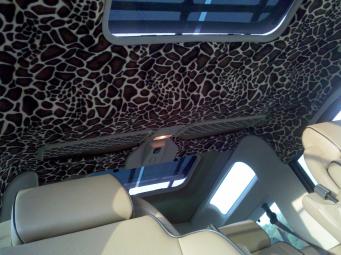

This is what happens when you let your kids pick out the material for a headliner refit...
Yes, that is a "furry giraffe" material.
It isn't completed - I have to tie up some lose ends but this was my first attempt to re-upholster a headliner. 10 hours and a 12 pack of cold ones to get this far.
My girls love it and I think I have a chance to get my truck on "Africa's Pimp My Ride"!!
Started out with a nice brown faux leather vinyl that would have looked real sharp but my girls said it was dull and boring and talked me into this.

I used 3M Super 90 spray adhesive. One can did the entire job. I set the nozzle control to 1, the lowest setting, and used a liberal amount.
I found on the vinyl the glue caused a bubbling that went away after about 24 hours.
The stuff is super sticky but you have about 10 minutes to make adjustments before it sets. The little liner I did pull on is stuck! I'm actually concerned I won't be able to pull it back in some spots to do the trimming.
I planned to just re-adhere the original liner but after shooting it with 3M 70 Spray Adhesive and allowing to dry for about 20 minutes you could pull it right up as if you didn't spray anything on it. So I pulled it completely and scraped the crusty foam off the shell, wiped it down with Goo Gone and allowed it dry over night with a fan on it. Came back the next morning wiped it down with a dry towel and started fitting the vinyl.
I've never attempted anything like this before but figured it wouldn't be too hard. It wasn't bad but there were a lot of little things I learned from one side of the liner to the other. !!! USE 2 PEOPLE !!! I tried doing most of this myself with my wife coming and going as I worked. Two people would have cut the time in half (duh).
Anyway it wasn't that bad and worth a shot if you need to have your's replaced.
