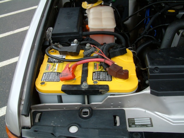

This is my dual set, real easy to build.

Your right Ted in regard to running the extra goodies off the 2nd battery, as to not be left with a dead battery to start your engine. I am still thinking about this myself. When DiscoMike said "he did not see the need for a dual setup" and then showed a picture of one I was confused at first. But, I remember him discussing this in the past.
The consideration of a dual setup is to allow the aux. (2nd) battery to charge, but not over charge while you are driving, as well as the primary battery to charge as it would normally. Some of the kits "dual setups" allow the 2nd battery to charge until it is charged, and then cuts it out while monitoring it and cutting it in when the voltage drops below some point, or something like that to prevent overcharging since it may not be used much of the time when you are around town.
DiscoMike's points discussed in the past, IIRC, was that as you can see from his pic, he just basically extended one more battery cable for + and - off the primary battery respective post over to the 2nd battery, for his dual battery setup. The key being that in his setup or "non-setup" that does not require a special aftermarket set of switches and battery monitoring devices is that the batteries are the same type and basically the same age. I cannot recall the logic exactly behind this. Mike can explain it further, but the main idea is they will have the same charging characteristics being the same battery, and being the same age would charge about the same rate. One not always charging before the other or something like that. As you can see, I am still learning this myself.
DiscoMike,
What did you do the stock battery tray to fit is the 2 batteries? Do I recall that you can actually get them in the stock battery tray?
