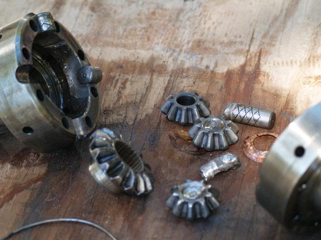

After wondering why my tires were rapidly disappearing (less than 6-7000k over half worn) I fitted freewheeling hubs to my disco (landcruiser diffs), and when in open center diff position, i still had drive, hmmm, center diff toast?? well xmas trip 1 weeks worth of driving later, I decided today to investigate what the issue was, pulled the transfer case off the back of the gear box and stripped, the center diff, is well, knackered, and thinking back has been since I got it, it used to "bang" when turning tight corners, but never had any drive issues or transfer slipping so to speak. so never bothered to look further. i did change the oil prior to trip and got a couple of little fragments of metal, but no filings in the oil and the oil was still clear. so ran with it.
https://i46.photobucket.com/albums/f...ps81ed7076.jpg
https://i46.photobucket.com/albums/f...ps77afcae4.jpg
A mate of mine has 4 dead discos in his back yard so may be a trip there with a set off tools and quick transfer case removal evening.
I discovered that if you remove the brake drum and backing plate you can remove the transfer with out dropping the cross member and the lh transfer mount. makes it a bit less labour intensive,

Try to get a newer t/case because those made thru part of the 96 run had both bearing issues as well as lubricating issue which were eventually corrected.

pedronz Feb 14, 2013 01:49 AM
got a replacement late 96 transfer from a diesel disco, seems smooth and quiet, will strip to clean inspect and reseal to try to eliminate oil leaks.

Finally got the thing back together tonight, i am using a '96 transfer on the '94 disco, and discovered the input shafts from the auto to transfer are different, the '96 input shaft spline is approx 15mm longer (up the shaft) than the '94, shaft is same length, so that set me back a few days waiting for seals etc to get a new shaft all fitted,
fired it up and back out of the shed and no loud clunk or bangs so seems to have sorted that issue, may be my imagination but it seems to free wheel easier when driving and less tire scrubbing noise when doing a u turn.!!!!
