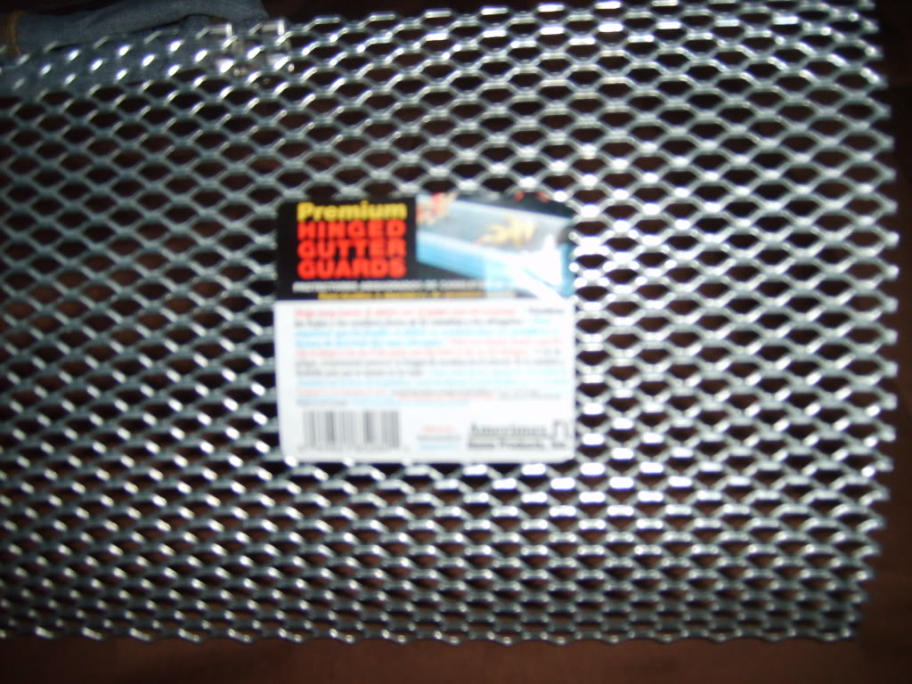

get some gutter gaurd for $2 at lowes or home depot
Attachment 47001

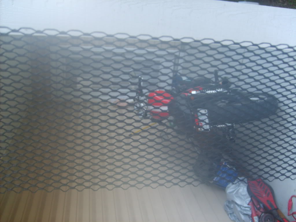

I painted mine (make sure to get your cool bike in the background)
Attachment 47002

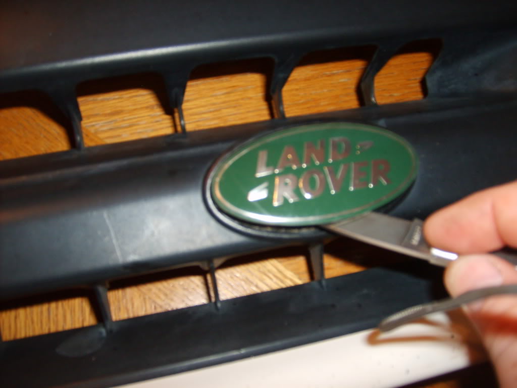

remove your grill and carfully pry out the lr badge
Attachment 47003

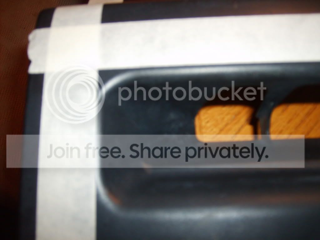

use masking tape to mark out your hole

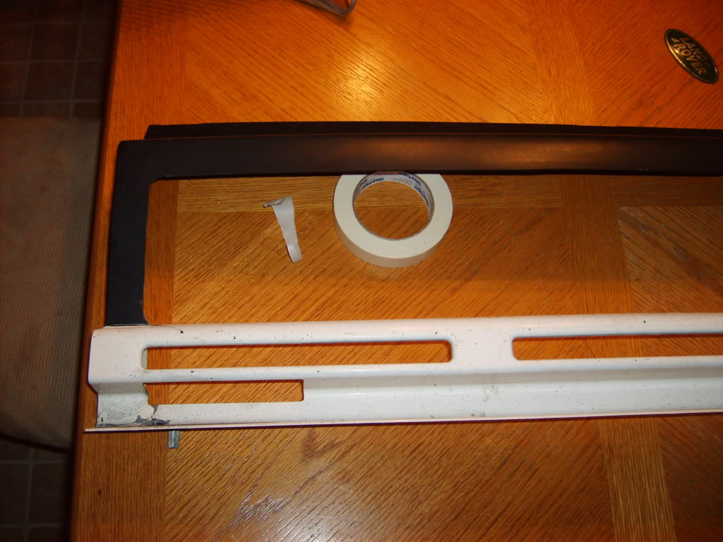

scuff the inside area around your hole with sand paper so the epoxy can grip the plastic
line up and tape your mesh to the back side of the grill

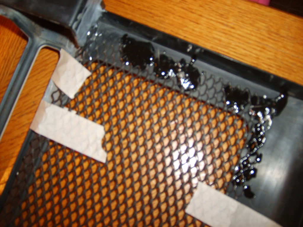

Attachment 47005

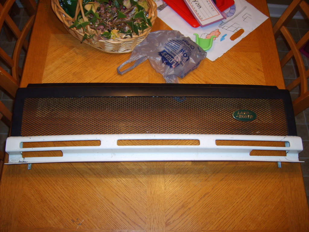

use epoxy to glue the mesh to the grill, making sure its tight to the grill
Attachment 47006

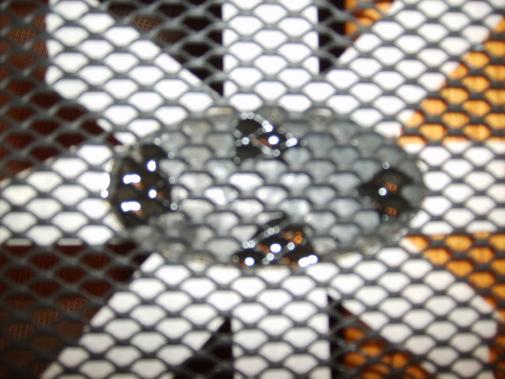

center your badge where you want it and tape it down, flip the grill and epoxy the back of the badge to the mesh
Attachment 47007

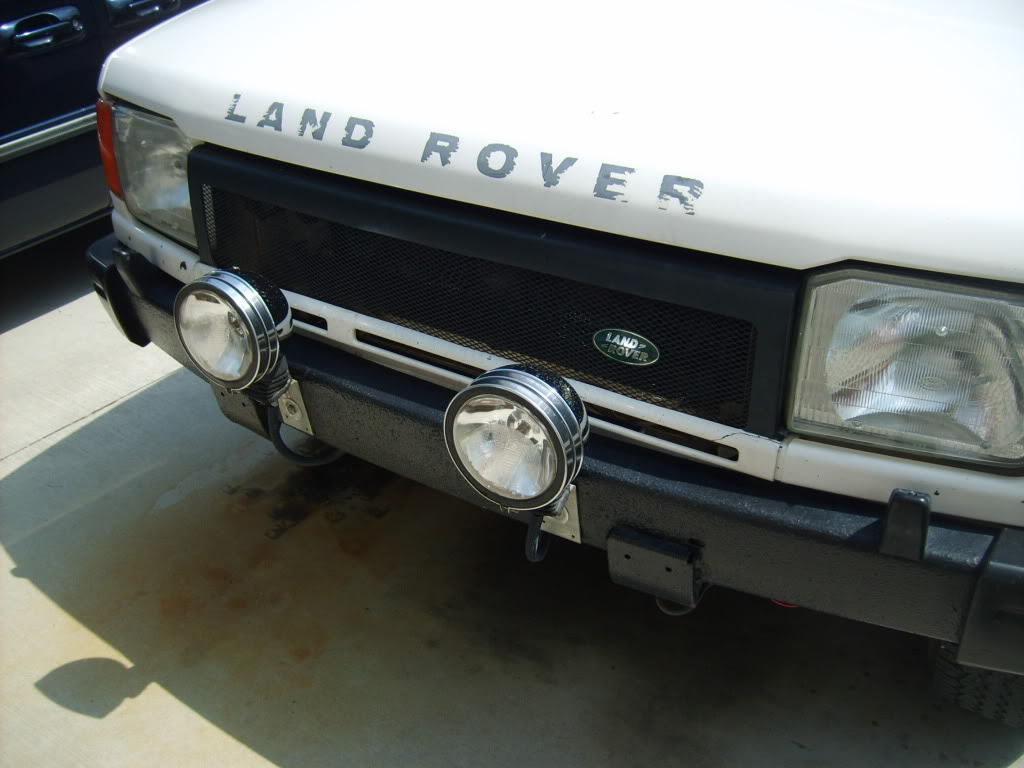

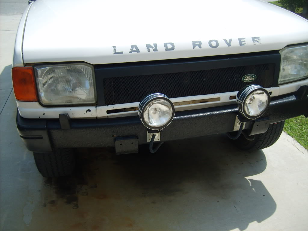

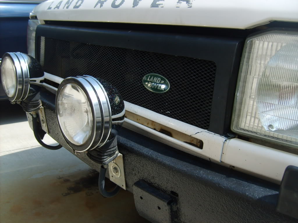

there you have it
Attachment 47008

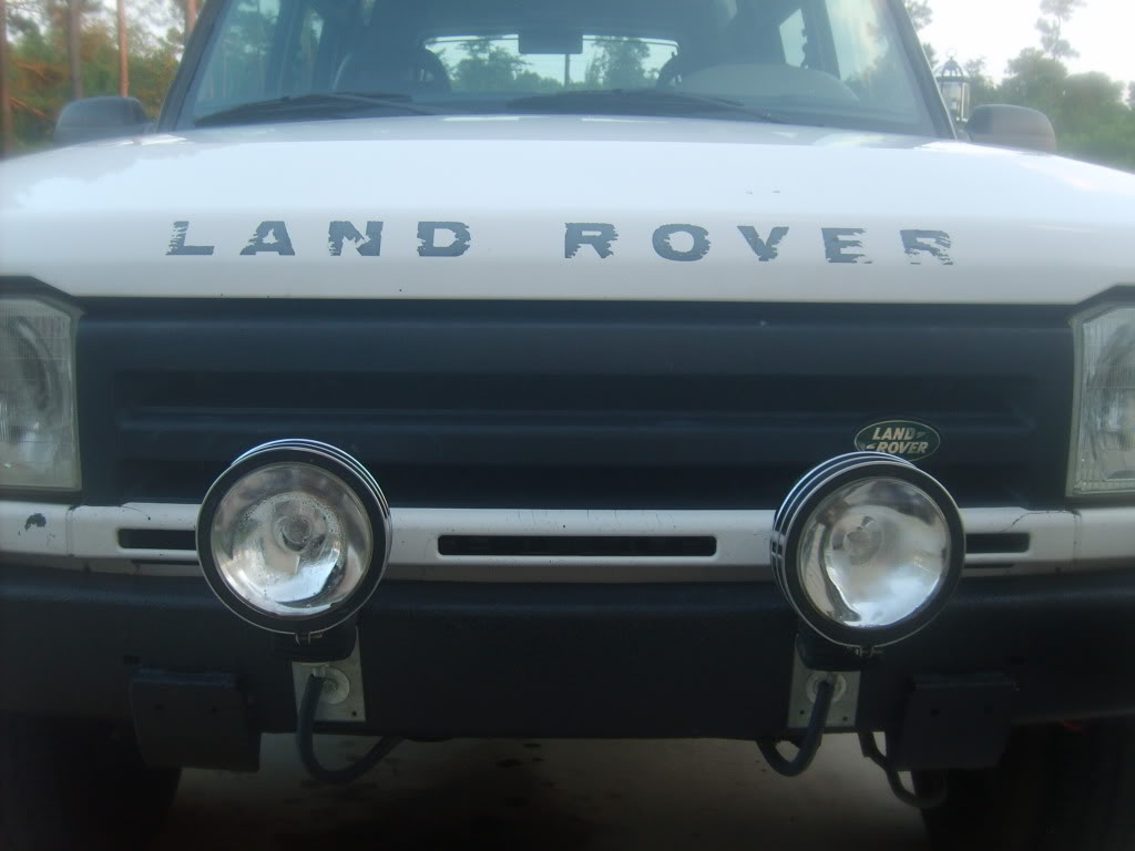

before
Attachment 47009
after
Attachment 47010

Update: after a few days I noticed that some of the spots of epoxy had let loose, after I removed the grill to see what was up I found that the epoxy had held fine but the paint on the grill had peeled of letting the mesh pop free. So when you epoxy your mesh make sure that the mesh is immersed in the epoxy so it wraps around it holding it firmly. What can I say its my first time doing this.
