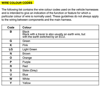

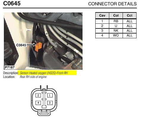

ljcobia4 Oct 1, 2017 09:52 AM
Anyone know how to wire up an o2 sensor pigtail??
Apparently the previous owner of my rover cut off or lost the o2 sensor plug on the truck side and now it's wired wrong and I can't find a diagram on how to get it right.
OverRover Oct 1, 2017 10:30 AM
https://cimg3.ibsrv.net/gimg/landrov...bb435731cb.png
https://cimg2.ibsrv.net/gimg/landrov...bf9e9be3d7.png
https://cimg0.ibsrv.net/gimg/landrov...8e9c20c519.png
https://cimg7.ibsrv.net/gimg/landrov...245b07f0b6.png
https://cimg9.ibsrv.net/gimg/landrov...736b906b22.png
Have at it :pointup:
