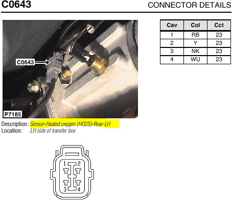

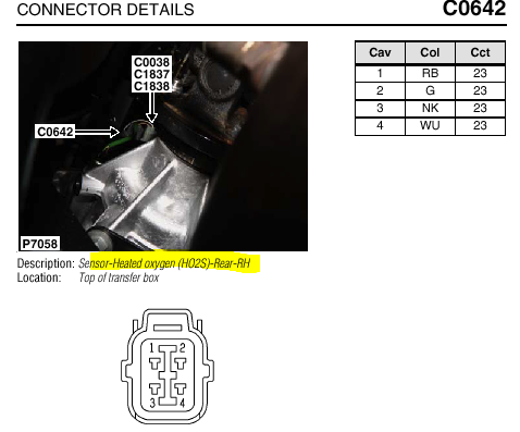

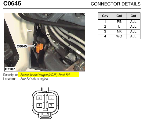

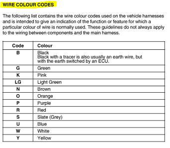

Apparently the previous owner of my rover cut off or lost the o2 sensor plug on the truck side and now it's wired wrong and I can't find a diagram on how to get it right.

Have at it
98discoj
Oct 8, 2014 10:35 AM
cosmiccharlie
Jan 16, 2014 08:23 PM
wrongway1
Dec 4, 2013 07:25 PM
awoods82
Mar 19, 2012 11:54 AM
tcbinaflash
Nov 20, 2011 10:47 AM
