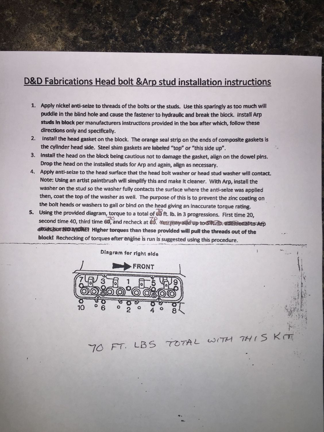

lwg Nov 29, 2016 05:03 PM
I recently did this using ARP Head Studs purchased from D&D Fabrication. He supplied the below instructions which were very useful.
https://cimg4.ibsrv.net/gimg/landrov...54b296e131.jpg
briancbev Nov 29, 2016 05:45 PM
I did this job ~2 years and many miles ago and tightened to 60 ft/lbs. Still runs great.
Luckyjayb Nov 30, 2016 08:21 AM
How well have they seemed to hold up only torquing to 70ft pounds? I'm still at a crossroads on using the stretch or arp bolts. Each comment has dang good insight and a valid point and I do like the fact that I can always remove the valve covers at a later time and recheck torque settings. Do you have a link to that companies website where I can check the price for arp bolts?also did you just screw them studs in hand tight or were u able to actually get them to go to the bottom of the bolt hole. Thanks again for all the input guys
Charlie_V Nov 30, 2016 10:19 AM
D&D is going to be on target with all of their advice. Now I regret putting mine at 90!!!
