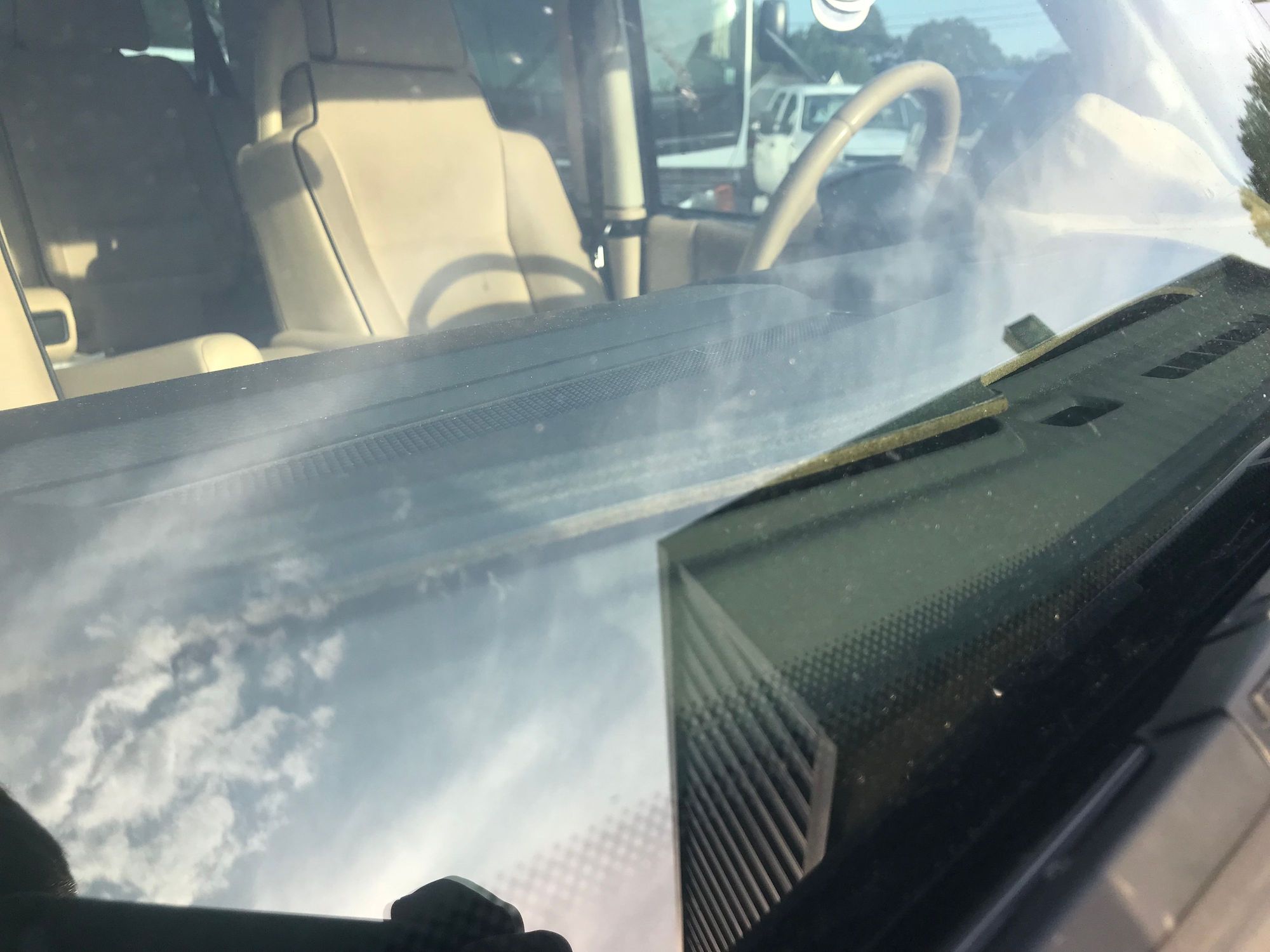

Anyone fixed this dash issue? I haven't seen any threads on it. If so do you mind sharing your experience? What should I do/not do. Glue used? etc.. I want a strong fix but I don't want to see any sticky/dried up glue.
https://cimg9.ibsrv.net/gimg/landrov...861fc0d37c.jpg
https://cimg0.ibsrv.net/gimg/landrov...49b2bfe811.jpg
Any input would be helpful!
Thanks!

Go to Atlantic British website search for D1 dash kit. It’s like 54.00 for the britpart version of the LR dash kit (D1 & D2 dashes are nearly identical). Get the black one, and install it. Then sit back and never worry about it peeling up ever again from the front! I’ve installed several into a few customer D2’s now and even my 04 D2 (pics of the dash kit are in the build thread forum).
I swapped the crappy screws out for the same length sheet rock screws & not only do they look better, but they were MUCH easier to screw into the hard plastic below the soft dash upper.

Year & miles have nothing to do with the dash curling. 94-04 D/D2 will all do it eventually. If it starts to curl just get the kit & call it a day.
