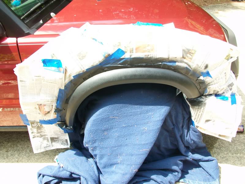

Next tape off the arches with painters tape and newspaper to give you more room to spray. Some people have taken the arches off to repaint them, but I've been told they'll never go on quite the same so I avoided doing that. When taping, take your time. You don't want black paint beyond the arches. Mine may look like overkill, but it was worth it:
Attachment 47059

Great write up, I would cover a greater area with paper or plastic, over spray is a bitch.
Camdisco24 Jul 24, 2010 06:53 AM
Yes I agree, If you don't have a very steady hand, more plastic/paper may be warranted. haha
