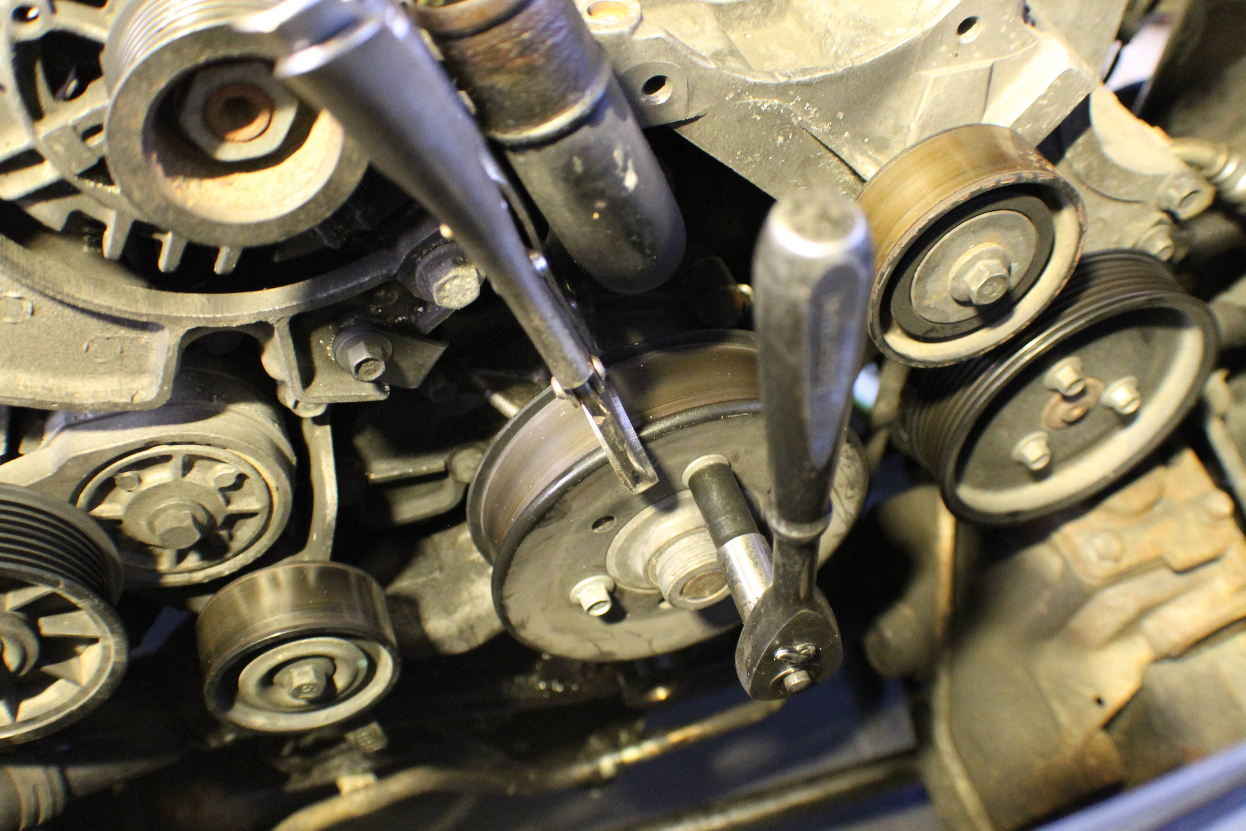

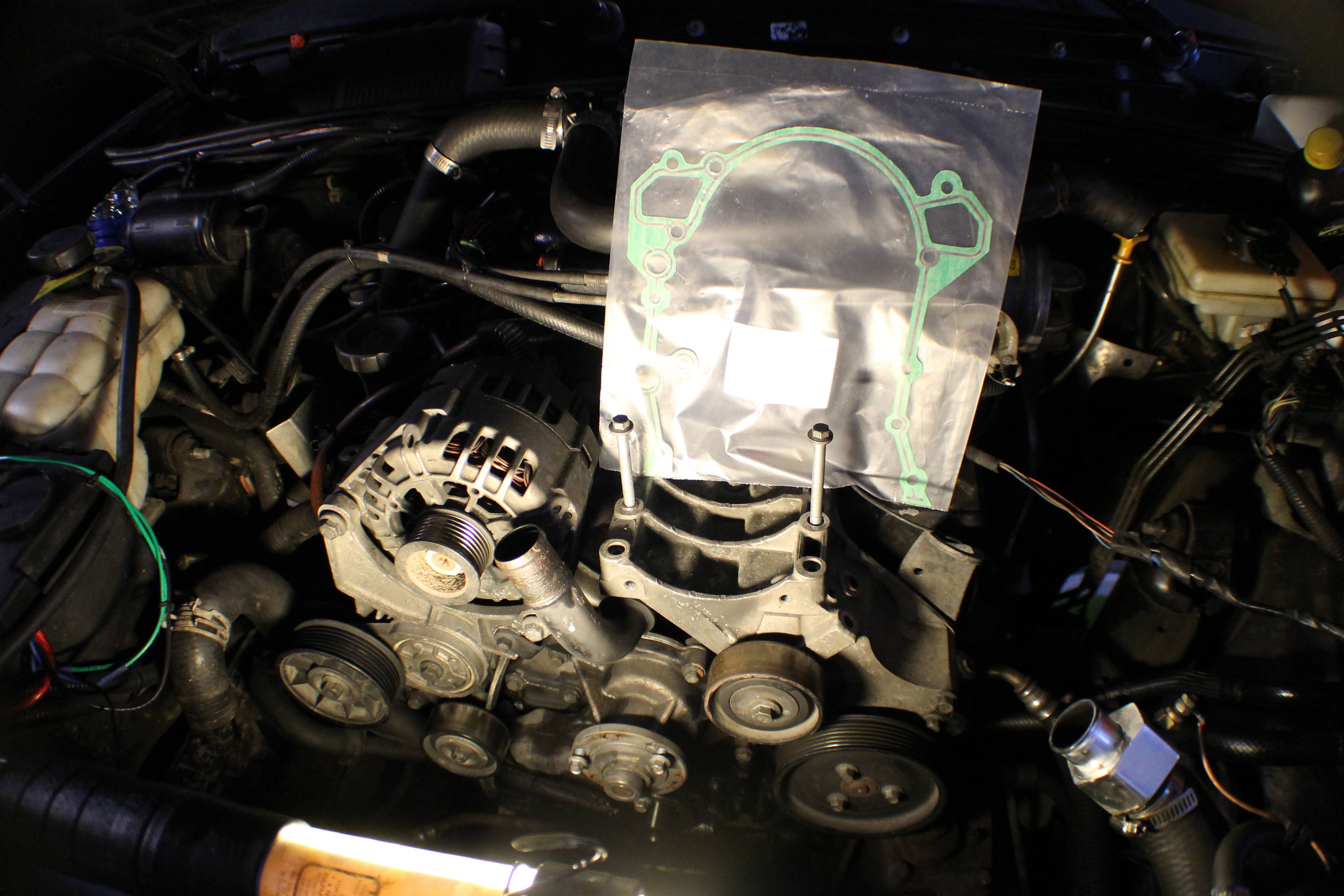

Now it's time to rejoice; you're now done laying on your back! For a while, anyway. Time to climb out and begin work under the hood again. This is the part where having a brush guard and a lifted truck sucks. We're going to start by grabbing your big pair of vice grips. You want to place them between the alternator pulley and the coolant tube on the intake manifold. Clamp it down onto the water pump pulley so it can't turn and remove the three bolts holding it on. It will come right out. I recommend placing the bolts back in the water pump so you don't lose them. Again, you can use this method with a large crescent wrench to remove and later replace the factory fan if that is the fan that you have and would like to keep. Attachment 56296 Now you also have to remove the idler pulley that's beside the belt tensioner. Sit it to the side with your harmonic balancer and water pump pulley. Attachment 56297 Alright, now you've got access to all of the front cover bolts. I recommend you take your new front cover gasket (if you've got one) and placing it somewhere that you can look at it so you can more easily find all of the front cover bolts you need to remove. Attachment 56298 ALL of the bolts you will need to remove will be 11mm. Do not remove any of the smaller bolts unless you also want to replace the water pump gasket. A good tip from me to you; if you have a modern smartphone, use the front facing camera as a mirror to look for the couple of bolts that you can't easily find. Helped me a lot. There will be 9 bolts in total that you will have to remove. Leave them sitting in their respective holes until you get the front cover removed and attempt to not spill them once you do remove it so that you can remember which bolts go in which holes. This is important because they are different lengths. Also, do not forget (as I did) to unplug the two sensors attached to the front cover before you remove it. Attachment 56299 Once you get the front cover out, lay it face up and remove the bolts. Lay them in a pattern that you will remember where they go back. Attachment 56300 Now, find a large phillips bit like this one. One of the smaller ones WILL NOT work, it will simply round off the screws and you will have to drill them out, which will suck. Ask me how I know. Edit: The bit is a #3 posidrive. Thanks drowssap! Attachment 56301 You will want to apply a lot of downward pressure while cranking on these. Really work the bit down into the screw and then really put your weight into keeping it down. If you do that, they all should come out without stripping. There's also that one odd little bolt by the oil pickup that will need to be removed. Attachment 56302 Now you can lift off the retaining plate and the oil pump will lift right out easily. If your outer ring gear is cracked, check for gouging in the front cover. If it has been gouged... I'm sorry. You'll have to replace the whole front cover which is rather costly. If you don't, you won't have enough oil pressure. Mine actually looked really good despite being at 143k on the factory pump inside the vin range for oil pump failure, and I don't believe the engine was replaced by the dealer because there is no recall service sticker under the hood. Here is a look at the old pump vs new, virtually identical other than the minor wear you would expect to find at 143k. Attachment 56303 Now, you'll want to seperate your oil pump's outer gear from the inner gear. Place the outer gear inside the front cover and fill the inside of it with your petroleum jelly. This is to make sure the oil pump gets primed quickly upon first start up. Attachment 56304 Once you've packed the outer ring, place the remainder of the oil pump inside the outer ring. Pack it with some more petroleum jelly and really work it down in between the two. Attachment 56305 Now place the pump retainer back on and tighten it back down the same way you removed it. Attachment 56306 At this point, I recommend flipping the front cover back over so it is laying face up and replacing the bolts back in their appropriate holes. Alright, now we move back into the engine bay. First and foremost, place the crank bolt (with spacer) back into the crank. Take your 15/16" socket and your breaker bar and rotate the crank clockwise until the mark on the cam gear is at the 6 o'clock position and the crank gear is at the 12 o'clock position. Attachment 56307 Once you've done that, I recommend taking a large crescent wrench and placing it on the crank bolt, laying between the power steering pump pulley and the power steering box, making sure that the crank and cam do not rotate while the cam bolt is being loosened. You will need a 1/2" impact socket for your breaker bar or a similarly sized metric socket in order to remove the cam bolt. Attachment 56308 Once the bolt is removed, the top gear will slide off of the cam easily and the chain will lower right off of the crank gear, allowing the cam gear and chain to be removed. Attachment 56309 And here is a comparison between the new chain (bottom, in case you couldn't tell) and the old chain (top). Attachment 56310 While you've got everything apart and removed, be sure to remove any remains from the front cover gasket. The next step is to take the new front cover gasket and slather it with some black RTV on both the front and the back. This will help to make sure you don't get any future oil leaks. Attachment 56311 Once you've got the whole thing coated and all the remnants of the old gasket scraped off, go ahead and slide the new gasket onto the dowels where it's supposed to go. Also go ahead and reinstall the cam gear with the new timing chain, making completely sure that you keep the dots aligned how they should be. The gear may only want to slide part of the way onto the cam. That's fine, just hold it in place and put the cam bolt back in and then tighten it to slide the gear the rest of the way on. It should slide easily. If it does not and you face resistance, make sure you have the gear aligned correctly with the cam. If you don't you will damage it. Now add loctite (I forgot this step and had to disassemble and reassemble again) you can torque the cam bolt down to 36 lb/ft. I didn't have a torque wrench, so I used my breaker bar and did the math. On a 2 foot breaker bar, 18 lbs of pressure on the end of the bar would torque the bolt to the required 36 lb/ft. Not the best way to do it, but it works well enough. Attachment 56312 Now go and get your front cover. By hand, rotate the oil pump so it will slide onto the woodruff key on the crank. Gently slide the oil pump over the crank, once it is as far back as it will go, rotate it slightly back and forth until the pump slides over the woodruff key. If it will not, then remove the cover and rotate the pump closer to where it needs to be and try again. Attachment 56313 Now, reconnect the two sensors that you disconnected when you removed the front cover. Don't forget that the oil pressure sensor has a retaining pin that will slide in to make sure the harness does not slide off of the sensor. Attachment 56314 |

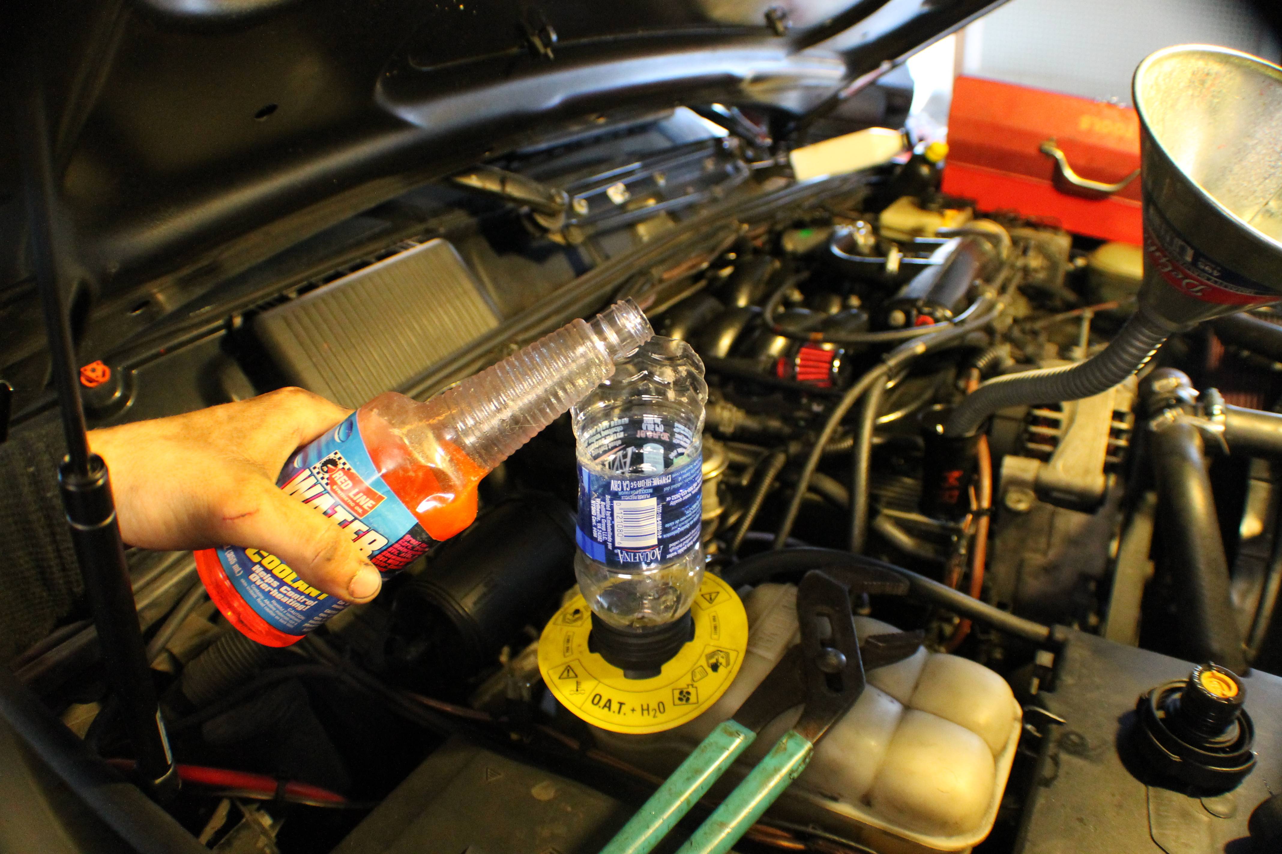

Now, move back to your engine bay and begin adding fluids. Start by adding your oil, which will take approximately 1.5 gallons.
Attachment 56277 Now move to your coolant. Start by removing the bleeder valve from your t-coupling so the air can escape as you fill. Attachment 56278 I added some water wetter first so that it would get mixed in with the coolant better. Then I added my gallon of coolant and then carried the jug around the house collecting half full bottles of water that the family had left laying around until I accumulated a whole gallon. I took that back and then poured it into the reservoir until it started overflowing. Attachment 56279 Attachment 56280 Once the tank starts to overflow, it's time to bleed the system. First, place your coolant pan back under the truck, this time under the t-coupling/bleeder valve. Super simple. Pop the tank up from the back and remove it from its mount, then take it and sit it on top of the battery cover. Watch the bleeder valve for coolant to start gushing out. Let if flow for a few seconds as there will be more bubbles that come through, but after a few seconds put the valve cap back in place. Attachment 56281 Now check your oil level and top it off if you need to. For this next part, I recommend unhooking all of your spark plug wires so that you can prime the system. Once you've unhooked the wires, hop inside your truck and let it crank over for a few seconds to get the oil system primed. Once you've done that then hook your plug wires back up and fire her up. Let it just idle until the RPMS drop, then let it idle a while longer. Watch and make sure that you don't have any oil pressure lights coming on, and if you do then shut your engine off immediately. I'd let her idle until she got warm, watching your coolant temps on an ultragauge or similar. Once she reached around 190, check to see if your coolant lines are getting firm. Crack open the bleeder valve a turn or so to let any air escape and close it back when you start seeing coolant come out. Once the system is bled and you have confirmed you're getting good oil pressure, pop the coolant reservoir back down in place and take her for a spin. You're done! Now, on the off chance that you're not getting oil pressure upon start up, I'd recommend trying RoverMasterTech's priming method that he outlined in this post. If you're not getting oil pressure after this then you've got a bigger problem that you will have to look into. Attachment 56282 I hope this write up helped! If you need any help, have questions, concerns, thoughts, ideas, recommendations, commendations, presidential campaigns, boxes of campaign, or lions to be tamed, go ahead and leave them below and I'll get back to you as soon as possible. |
