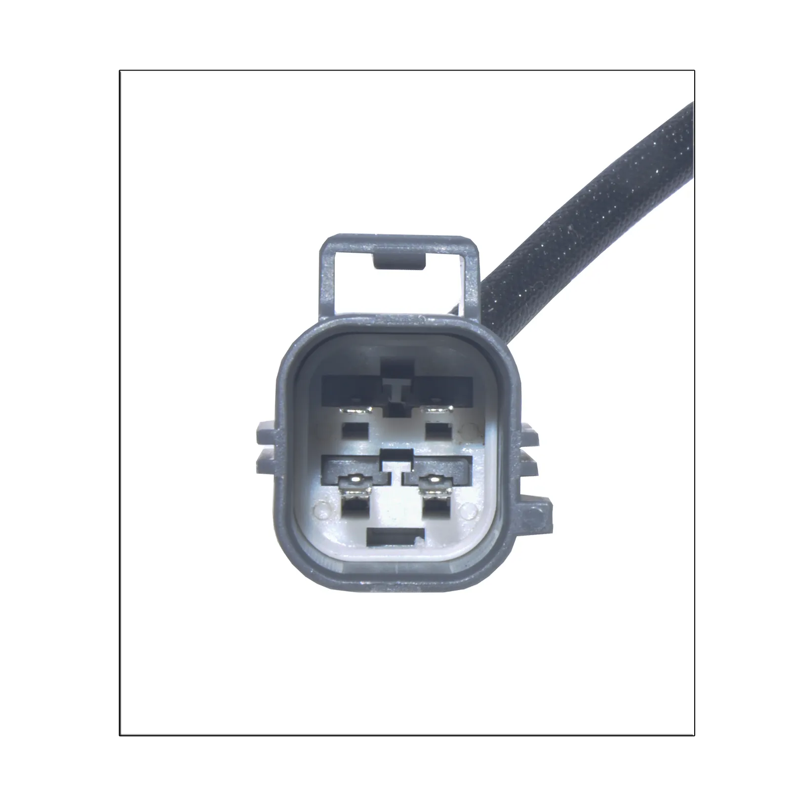

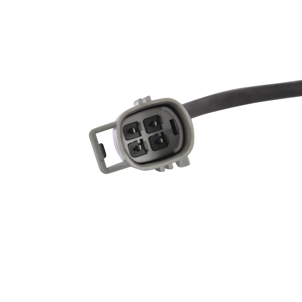

The upstream o2 sensor connector on my 2008 has rounded ends, not completely square. But everybody thinks LR001459 should be a completely square connector. ??? Which one is it?
Does your LR2 have this type of connector for the upstream O2 sensors?
https://cimg2.ibsrv.net/gimg/landrov...9eb0f33da5.png
Or this one?
https://cimg2.ibsrv.net/gimg/landrov...4399c12eeb.png

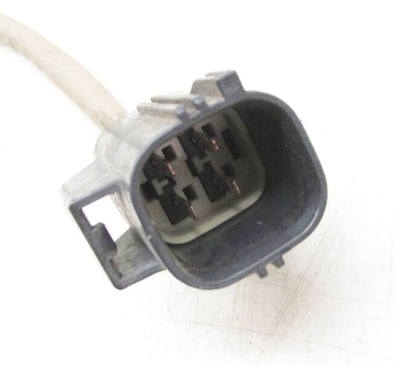

Check the USED parts for sale on eBay to see the genuine item. Here is one:
https://www.ebay.com/itm/152251653477
However, the part # they provide might be the equivalent Volvo/Ford part #. The second to last photo in the eBay listing shows the view you want.
https://cimg2.ibsrv.net/gimg/landrov...70e0fd0237.jpg

That's not it... I think I'm gonna have to cut off the connector and splice the wires to a new sensor. I don't have a clue how the heck this happens.

I did. Of the two pictures you posted, the Denso sensor has the first type of connector, which is the same as what my LR2 came with from the factory. With that, I was just answering your original question.
That that's not the connector yours has is definitely weird. Do you have a picture of the actual connector on yours that you can share? I have a bunch of O2 sensors from various vehicles in my shop, so maybe I can identify a part number on one that matches your connector.

Look at the second picture I posted. The ends are rounded. What you have is more square.
Yes, I get that. But I think we're talking past each other here. It's not clear from your posts if the connector you actually have is either of the two you pictured. Hence my confusion.
