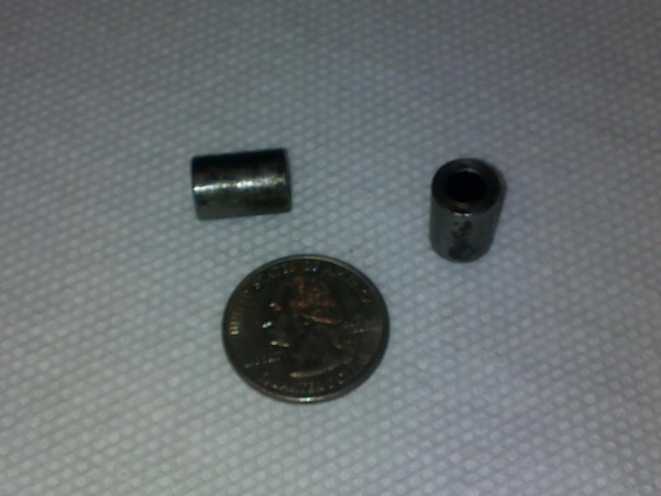

HELP!!!!! attached is a picture of two identical pcs i found in the bottom of the oil pan

Hell I would be worried if I found those in my oil pan. People on this board have taken rovers apart numerous times someone MUST have seen these items.

They look like a spacer used to support the oil pickup. Maybe the assembly line left a couple of extras in there. But seems like they would have come out in the oil drain at some point...
