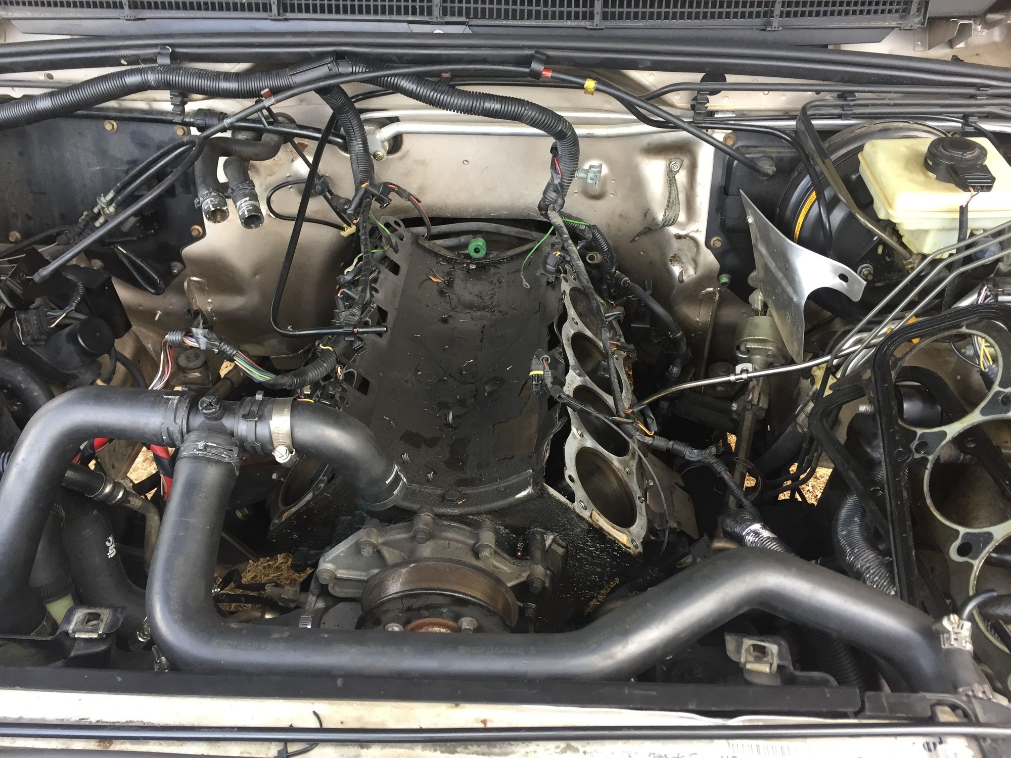

WoW! Thats great! You got almost everything there replaced. My budget was tight so I just power washed the heads! lol! I just finished my HG today. Tough but fun doing it. Cheers!
Well the budget it somewhat tight due to Christmas and my wife but I've been ordering little by little up until I got in trouble! Great news was I got it all pretty much ordered. She thought it was gonna be quick and cheap and I tried to tell her it would cost at least 1k but she didn't believe it. I'm looking at getting it all done right the first time because honestly, if the heads leak again, I'm just gonna pull the engine and have it rebuilt. But I figure she has all the Christmas shopping done so I can get back to my other lady now and get her back running right. I work for the railroad so my time is limited on some days. I had a big rainstorm the other night and noticed a little water in the rear cargo area and a little in the passenger mat but I suspect that is the door seals going bad. It is sitting on slight downward incline and the rear door shows the tell tell signs of a leaking door gasket. Gotta order those now and do a little adjustments. I did recently repair the sunroofs and those show no leaks but just to be on the safe side, I'm gonna remove the headliner and remove the sunroofs and replace the silicone with high temp rtv to be on the safe side....don't want the Alabama sun to eat away at the regular silicone within a summer.
My Experience with HG
Your right with getting all the right stuff and getting it done right. This was the first time I did this kind of fix. a MAJOR one for me. Anything could go wrong, from removing those tight head bolts, all the angle and position to take it out etc. Worst part is that my son helped me in the beginning so he did some disassembly while I get some tools. I only have some adjustable wrenches and assorted screw drivers. I event have to google breaker bar! But once you get started, there is no turning back. Took us over 3 weeks including waiting for parts, rainy days, freezing temperature and missing bolts that had to be ordered, those pulleys, belt and tensioner which was last minute at after I completed the job and found out the belt was loose and everything was squeaking. I test drove today for 50 miles, so far no leak yet. Cheers!
