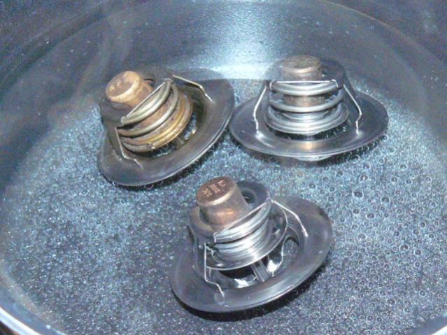

I have a D1, so different stat. When I have a 180F stat in mine, it runs 180 - 183 down the highway at 50 mph. American standard numbers for a stat are the opening temperature. The RAVE says the D2 stat starts to open at 180, and is fully open at 204. Here's a pix of something I cooked up. You can see that the stats are open various percentages. The 180 is open most, the other two are 195s.
This is basically what is inside the heart valve assembly of the D2. The four little holes on top being hot water to make it open. More hot water would make it open sooner and further. In a D1, the business end of the stat is totally immersed in the water.
People have changed theirs, without much change. Some new ones have stuck closed. I would suggest drill four new holes, about same size. Watch what temps do with a scanner or ultra gauge, if no improvement, new stat. Temps running should be in 190's, not 210, etc. Temp at idle will crawl up, that is normal.
