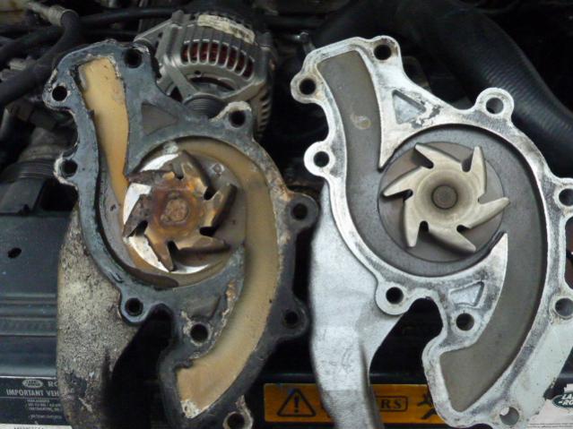

Water pump sieze up and release (usually have some belt squeal, or noticable pulley wobble at certain speeds)? WP left in pix would wobble and drip out the front, I thought it was AC condensate until I looked closer. WP would give coolant loss and over heat on/off with approaching lock up.
