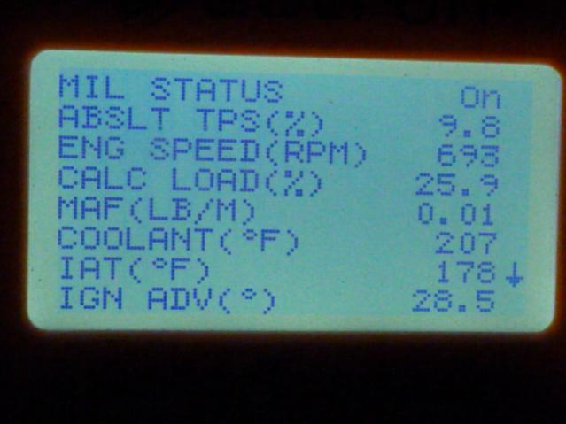

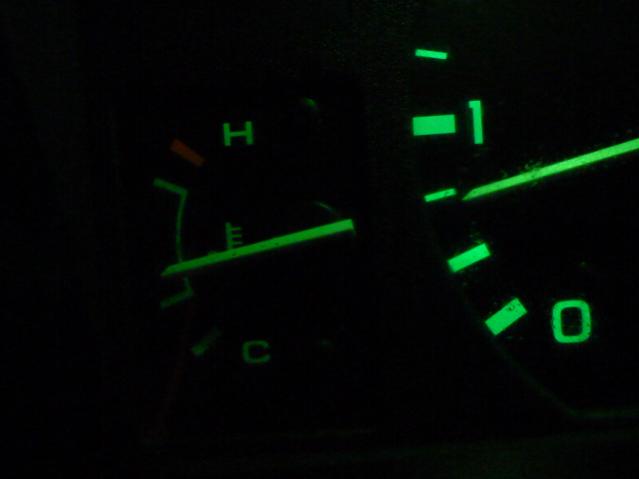

Pix of my 4.0 liter D1 temp guage and scanner at 207F. Temp is monitored by ECM on a two wire sensor, near themostat. Temp guage runs from adjacent single wire sensor. 12:00? Wow!
Haha, on the P38 (mine anyways) the temp gauge is horizontal. Thanks for all the info. Is there anyway to visibly see a slipped liner? They all seem to be flush. I will definitely check out a 180 stat for sure. I tried out two thermostats that I had available. One I know was working the last time it was on a vehicle but it has been a while since it has seen action. Will for sure get a new set of bolts with the gaskets.

Bad thing about Rover gauges is that they are designed to reduce service complaints - they stay in the same place. Mine reads the same from 145 on the scanner to 239, where I chickened out...

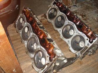

what cylinder had the rusty valves??
If it was one of the middle cylinders then a good chance the block is cracked behind the liner and once things heat up the coolant goes behind the liner then gets into the combustion chamber, there was an outfit that made clear plexiglass covers to simulate the heads and thus was able to pressurize the coolant system and find the leaking cylinder they did extensive testing to figure this out seems that #6 is the likely culprit

Mrmerlin, to me it looks like ALL the cylinders had rust on the valves. See the attached pic. The white valves are what I would interpret as burnt coolant, maybe not rust yet, mostly on the exhaust valves. But I could be wrong, I am new to this 4.0.
When I checked the cylinders for water before I removed the heads it only blew out of #7 and #8.
