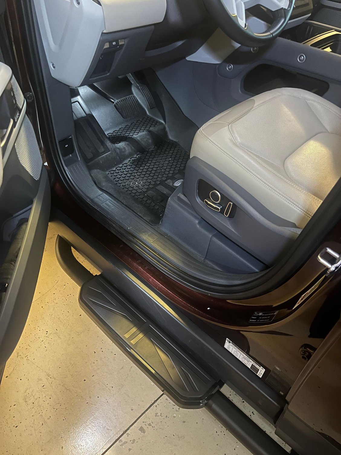

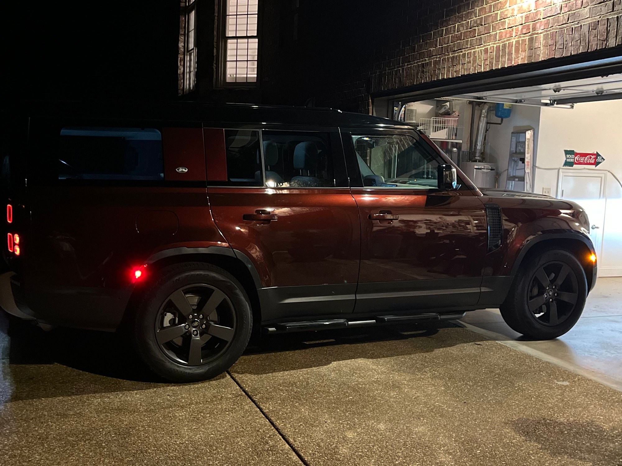

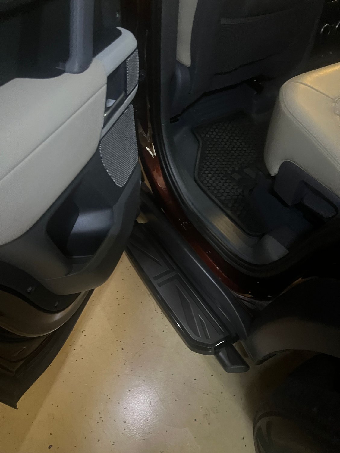

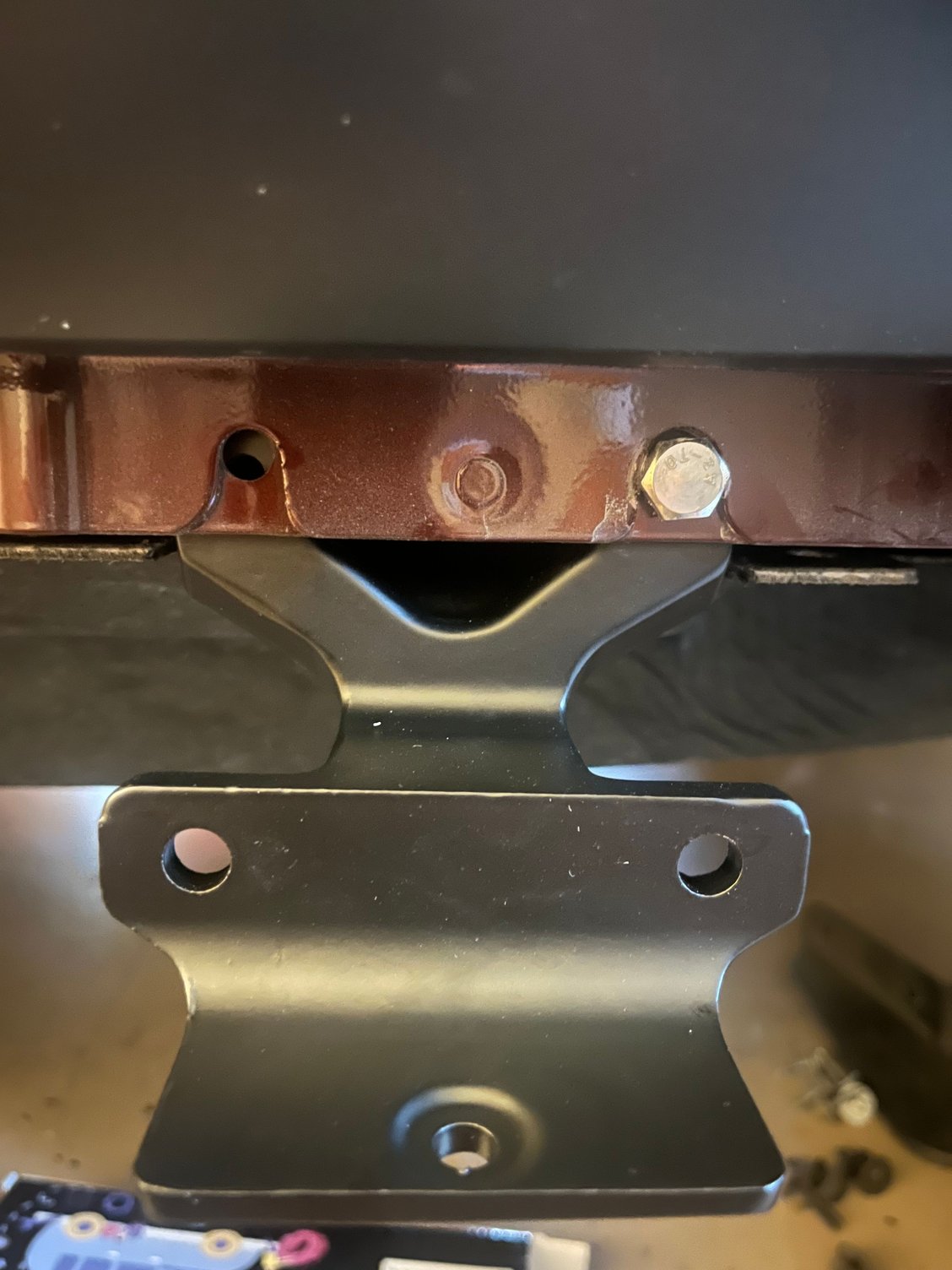

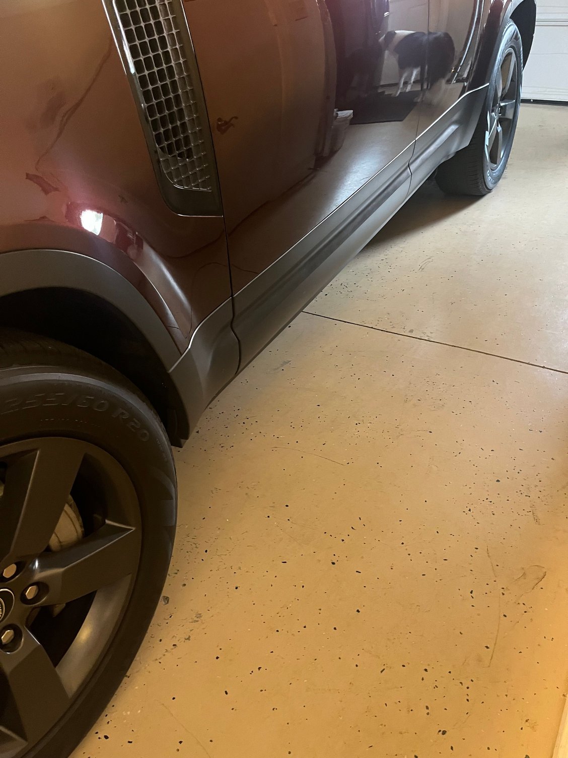

Installed the side steps on our 130 that I ordered from Lucky 8. Had to wait a while for the Union Jack ones to be re-stocked. Watched numerous videos. I was nervous yanking off the cladding (first time!), but everything went pretty smooth. The only issue I had was that the rear brackets (clearly labeled for each mounting point), don’t account for the mounting hole towards the front being a smaller opening on the “frame” than the hole towards the rear (see pic). I was finally able to get the passenger one in, but the driver side (in the pic) was impossible. So, the driver side has seven bolts in instead of eight, but missing just the one “side” bolt in the rear bracket doesn’t concern me. I took my time…took 4 hours on the driver side (first time), and a little over two on the passenger side. Definitely could do them in two hours for each side if had to do it again. :-) Before and afters...
