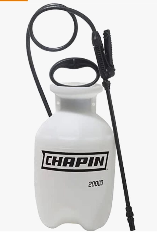

Regarding your comments about clearing mud from the windscreen, when off-roading I sometimes bring a hand pump sprayer to easily clean dust, dirt, mud, salt spray, etc., from any sports equipment after use like a kayak, surfboard, SUP, or similar. Seems like a great addition for an off-road excursion where mud or dust could pose a problem. Takes up little space, and can even be used for a personal trail side shower.
And, this looks a whole lot cheaper than the LR portable rinse system accessory
