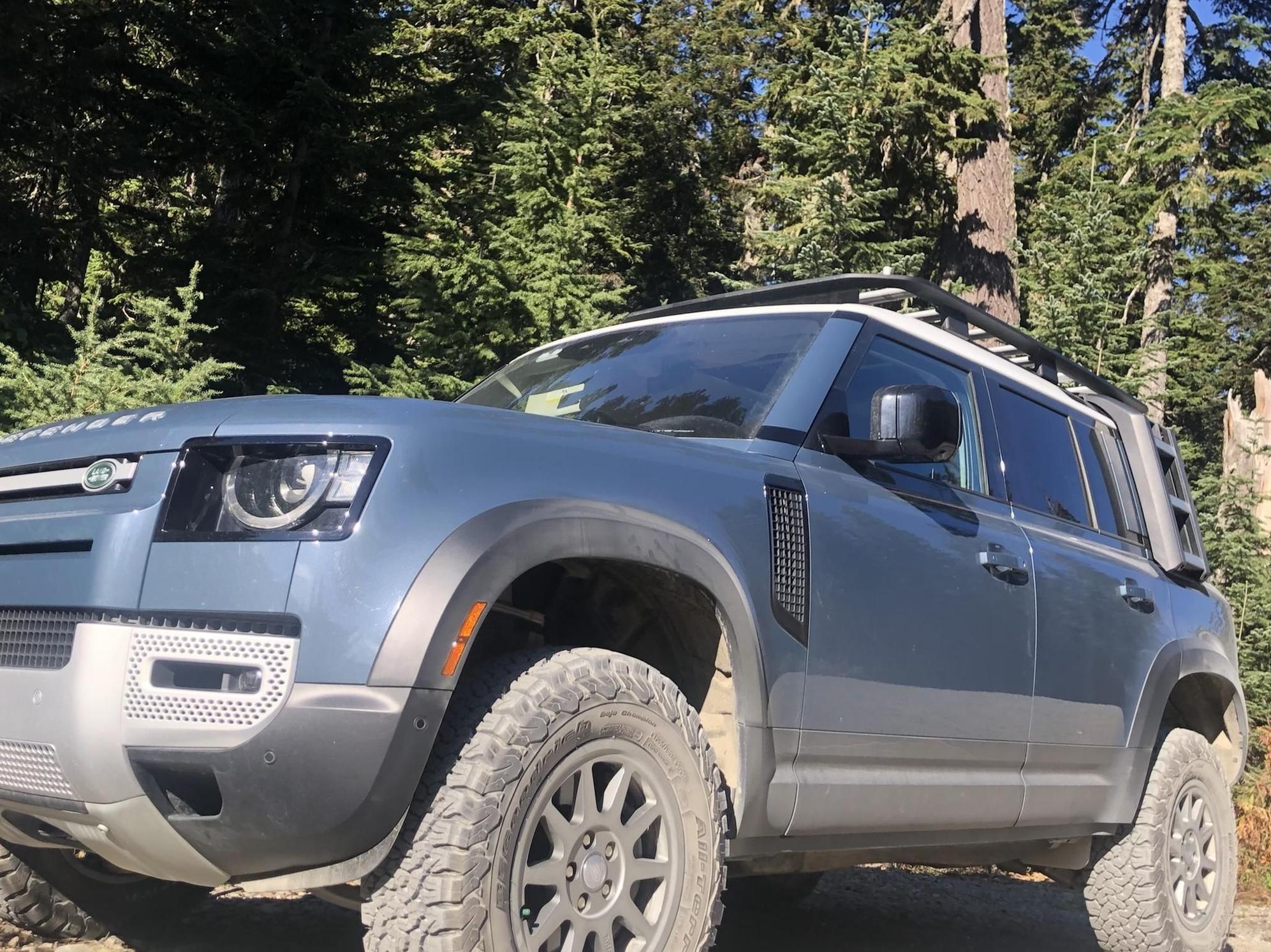

I debated the same very question before going with the 265/70 R18
Pro
1: You get the bada$$ white lettering in the bigger size. (My other half vetoed the lettering so they are hidden on mine. sad)
2: Extra 1/4" of sidewall. Every little helps
3: 1/4" extra ground clearance. Free lift. haha
4: E rated. I wanted as tough as I could get for the rocky, root ridden trails I wanted to tackle. Gives great peace of mind knowing you have meaty sidewalls. D is probably more than adequate but why not turn it up to 11.
5: 32.6" is as big as you can go without a lift.
Con
1: Speedo is slightly off. ~1mph at 60mph
2: Greater unsprung weight in the 265
3: You will be forever bitter if you are prevented from displaying the glorious white lettering.
You will need to drop down your psi if you're on any sort of corrugations. 50psi on corrugations will rattle your eyeballs as I learned fast. I run them at about 40psi for day to day. I've gotten myself Staun deflators and an ARB compressor now. Looking forward to playing more with air pressures in the months ahead when trails become accessible again.
