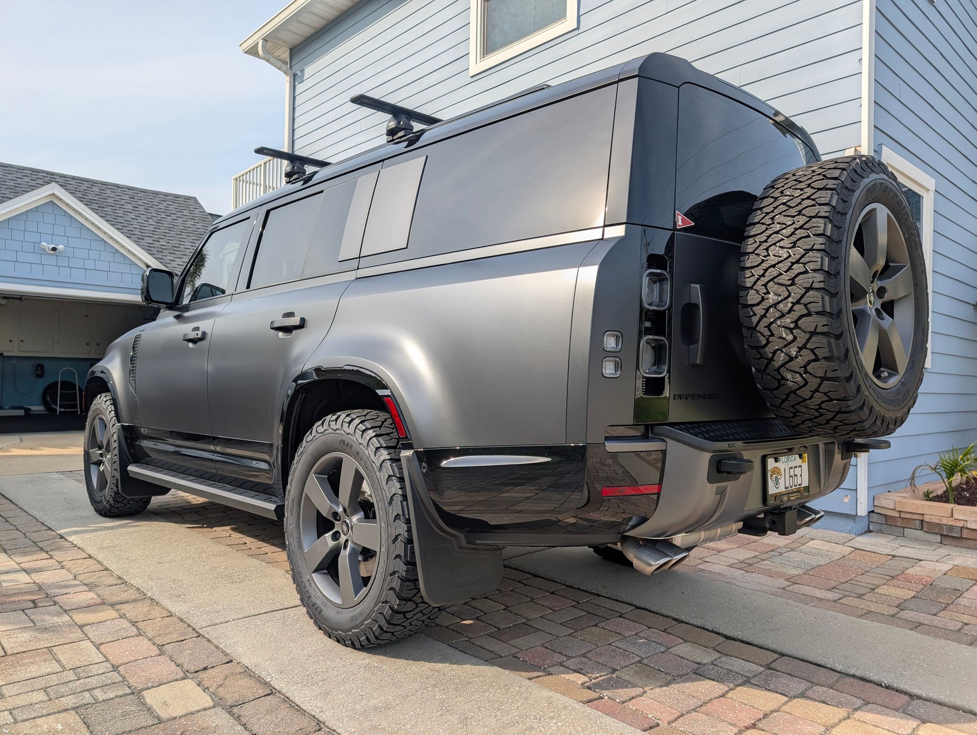

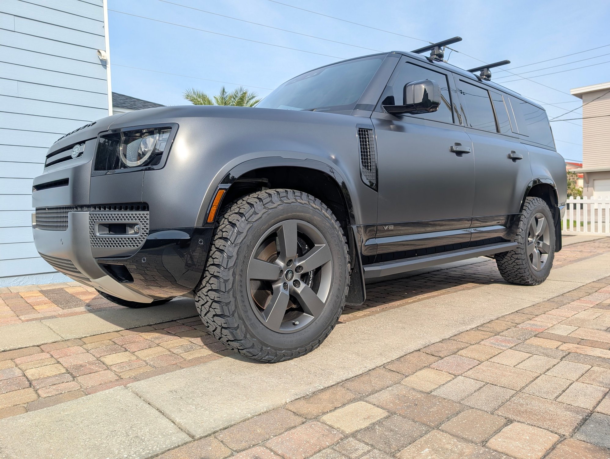

This size ko3 finally came out this month, just had them put on. I have a 1" lift on it, zero rub at regular height/full lock. Shocked how quiet they are on the road compared to the ko2s I had on my LR4 a few years back. So far so good, thought I'd let y'all know in the event you were looking.

That's a beaut of a V8 build. Tremendous.

Absolutely badass truck. Those tires look unreal. Any word on whether these fit no rub, no lift? (A guy can dream)

Zero rub. I did remove the front rubber wind diffuser because it looked like it could get in the way.... This thing pictured below. Plus it just looks better without it.

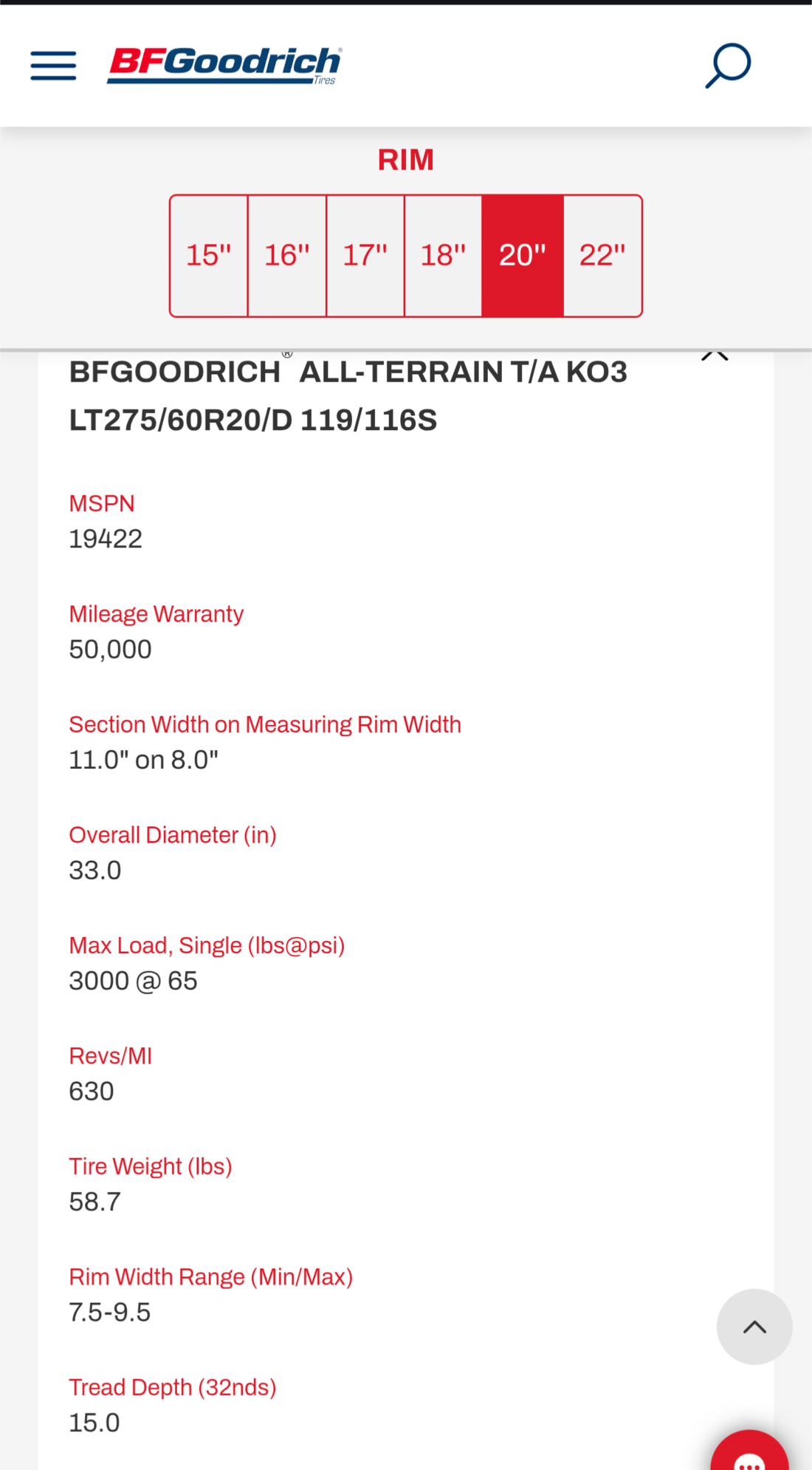

I can only speak for the air suspension setup but I had these installed at the dealership and they moved them every which way to make sure they didn't rub. I also drove up an inclined driveway to see if there was any movement that would've caused rubbing and there was none. I made my decision on these 33s specifically because the BFGs run just a tad smaller and the reviews state they are quieter than the ko2s. So far I'm loving them. It's a PITA to go through all the forums for this info so hope it helps. On paper these are 33"x11"... But once again the BFGs run a tad smaller. I used the below to help me:
