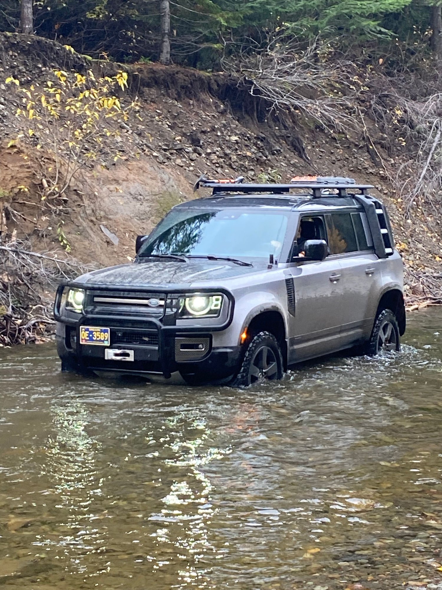

I put a hidden winch and Aussie metal bullbar on the front of mine, which gets a good bit of use. Also lifted it 1.5" with 33" (bigger diameter) tires and absolutely love how cool it looks. Note: My advice would be immediately put better tires on it - K02's/Wildpeaks in a larger size or similar. That's your biggest difference in capability offroad.
Other Accessories? JLR Roofrack, dog guard inside, waterproof seat covers front and rear for me, and the side ladder are great to use too.
Basically it's a big toy. A big grown up toy. I freaking love it.

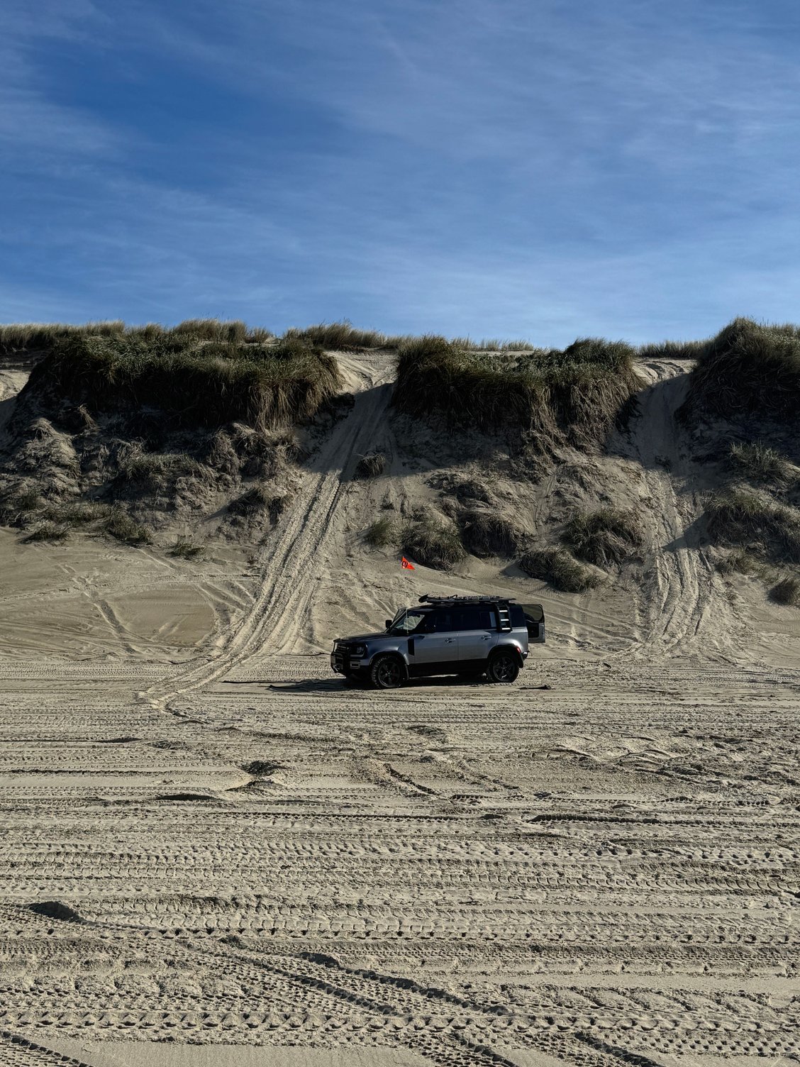

Here's me lounging in a creek this past Saturday. And then in the dunes the Saturday prior...
Cabin Creek Road in Snoqualmie Forest, WA
Florence Sand Dunes, OR
