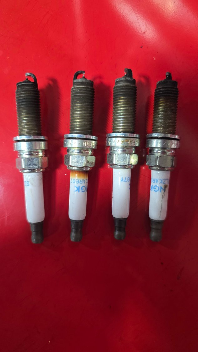

Agree with gavin. I had this happen and the crazy thing is that it set no fault code nd no check engine light. Eratic thudding. Needless to say, pulled the spark plugs and found the culprit. Crack in the ceramic
Replaced all the plugs and symptom gone. This was at 120k. I had replaced them once already at 60k. Funny thing was that this happened again shortly after. Replaced one ignition coil and it subsided. Then again. Replaced another. Ended up replacing all 4 coils and now it had been 10k miles and no issue.
