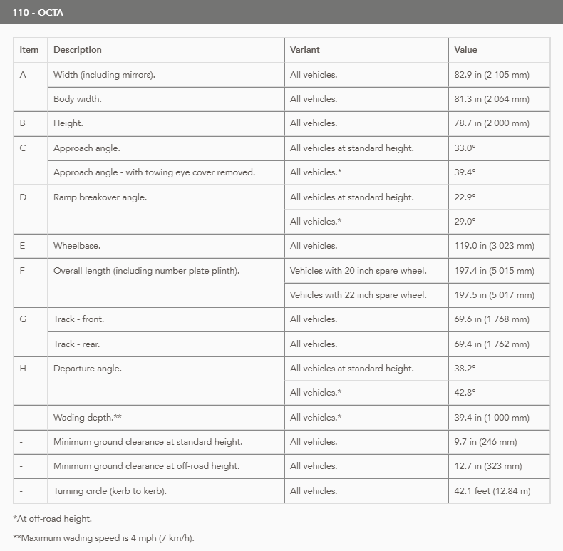

I've researched the height of the Octa online, but I'd like to really confirm from those who have actually have the Octa.
If it's not too much of a bother, the height of the Octa in;
Transit Height and
Access Height.
I use a couple of parking garages, one of which is at a hosptial, of only 6'6"
As I understand, the access mode allows you to lower the vehicle also for this type of situation - lowering and driving into the parking garage. Is this correct?

Correct, access height allows you to lower down and drive into tight garages. You can also lock the suspension in access height by holding down the lowering button. The dimensions on Land Rover's official website should mirror the dimensions that can be found on the vehicle dimensions menu on the Pivi screen. Plus, those dimensions listed online are accurate when it comes to the standard Defender. Of course, that doesn't take into account any accessories such as cross bars, larger diameter tires, lift rods, or a roof rack.
This comes directly from JLR. Specs are in normal height. Access height is about two inches lower than standard.

This is great, thank you. This helps a lot and confirms the unofficial numbers I was seeing online.

I would not park in a 6ft 6 garage. Yes you can lower the ride to have 1 inch of clearance. But when you start it up you might accidentally go back to normal height. Seems like a very costly mistake...
I had a metal plate made up on Amazon that gives a 6 ft 8 warning and stuck it on the dash next to the steering wheel. As a reminder of where you can park!
