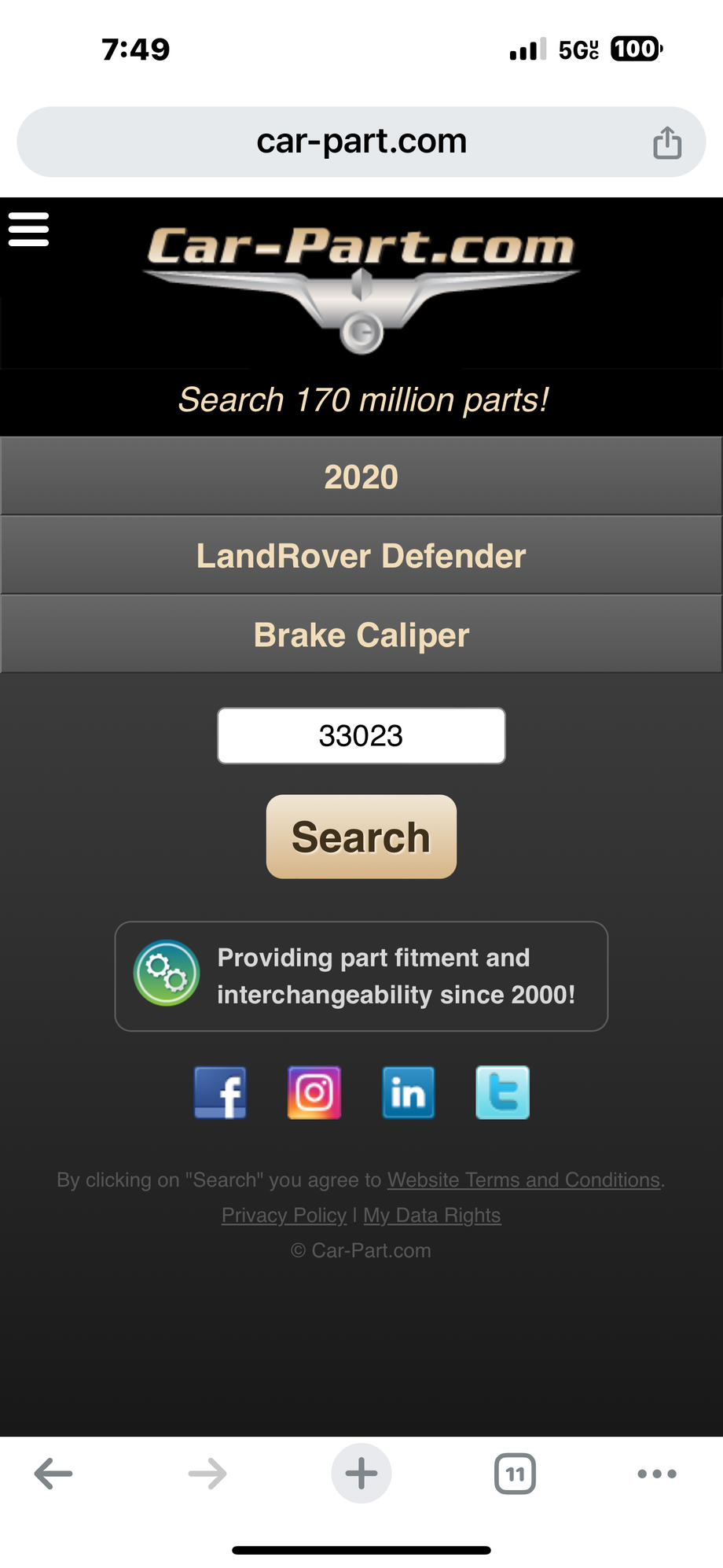

Is it factory or after market? Also try this go to car-part.com and input your vehicle information and it will show a list of vendors all over the country that sell that part. That is how I got a front headlight for my defender after a rock took it out. Parts are used but most companies warranty it that it works. Just an idea.

car-part.com is good, but with one is hard to search on that site. They don't have a drop down for "fridge, refrigerator, cooler, etc..."

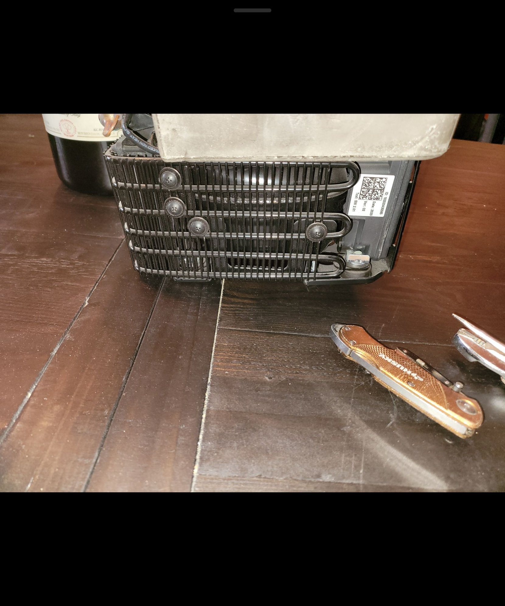

The fridge is found on ebay for less than 400 dollars. Most of the newer fridges for most models fits in the defender. I retrofitted a velar fridge for my defender. There is one plastic cross bar that is revealed after you take to the top cover off. You dremel that cross bar and most of the fridges will drop in plug and play with a tap of the cigarette lighter outlets in the back of the console.
