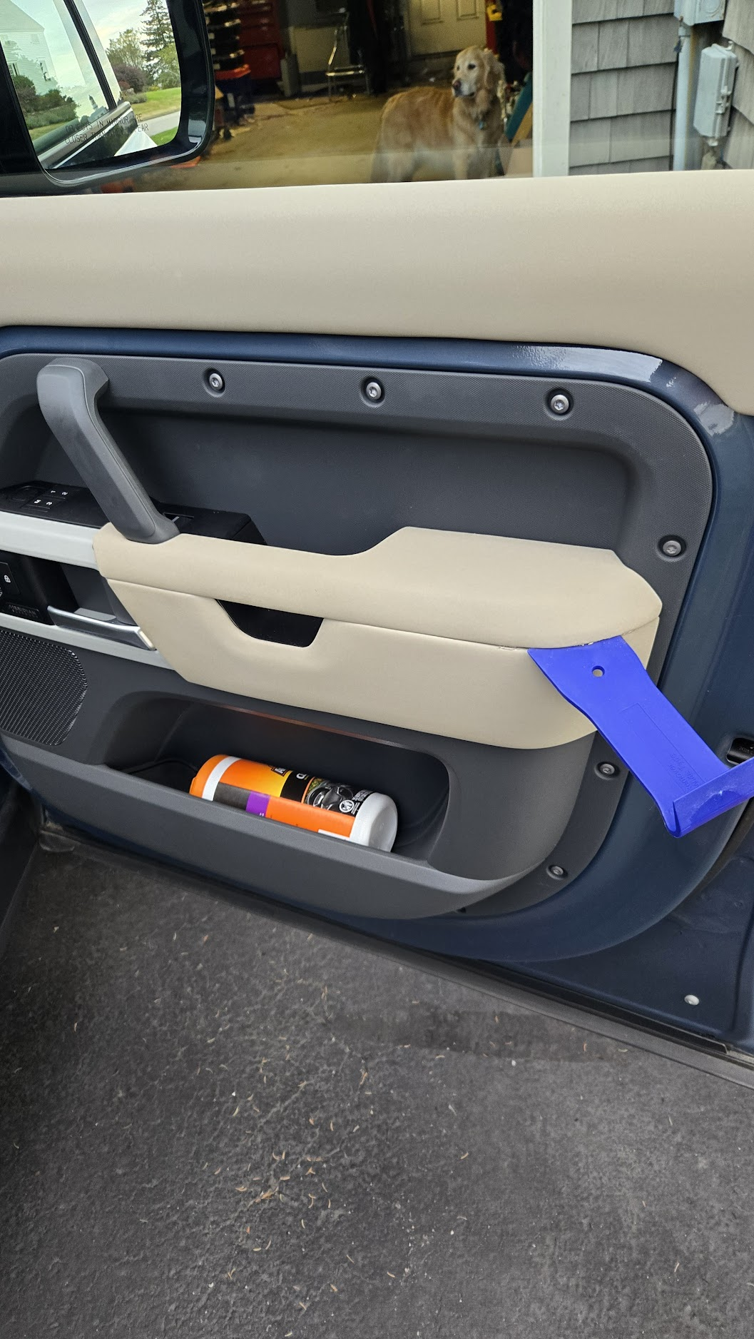

I'm the passenger prince in the Defender and every time I put my arm on the arm rest - or rest my knee against the armrest (I'm tall) it makes this really annoying sound that I recorded:
Like I ask in the video - am I being nitpicky on sound? It really strikes a nerve for some reason.
I've tried to pull the arm rest off like in the PowefulUK video starting at the rear of the arm rest and pulling up - but no matter how hard I pull it will not come off. I even tried using a trim tool to pry it up. No dice. I actually lifted the truck on the suspension trying to pull it off. Any tips?

That’s insane I would go nuts. You’re good to be annoyed by that. All is fair. Mine make no such noise. I’d drive the car off a cliff.
The armrest pries OUT from the door panel. (not in half and apart where you are prising it apart)
1) Would a 2022 not be under warranty (maybe not because of mileage) -- if not, dealer this.
2) Please see this photo from the official LR workshop manual that will show you how to remove that. Note. There is a really tricky hook that goes from the top downward, by the inner pull handle. Do not break it. Basically -- you pull it towards the inside of the car -- not like you're doing.

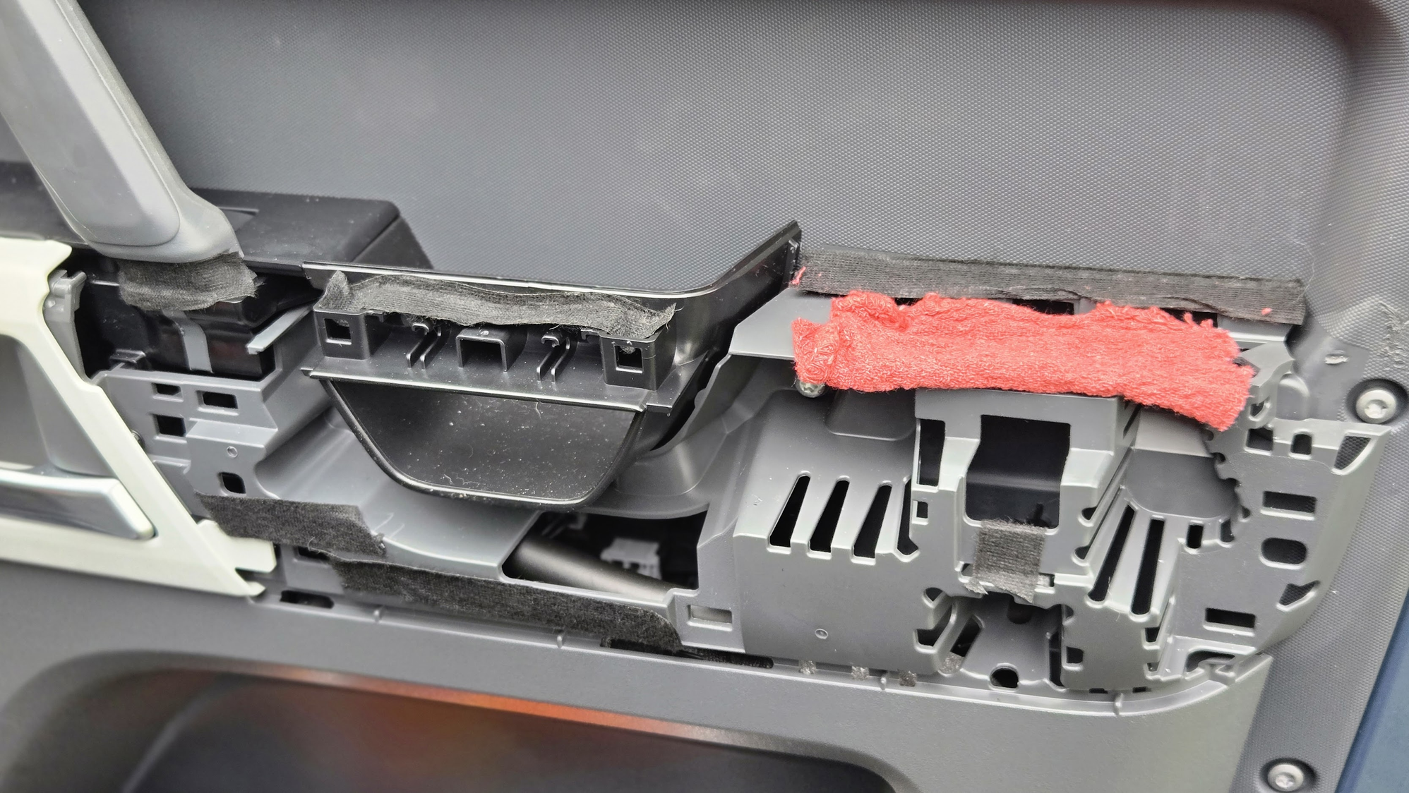

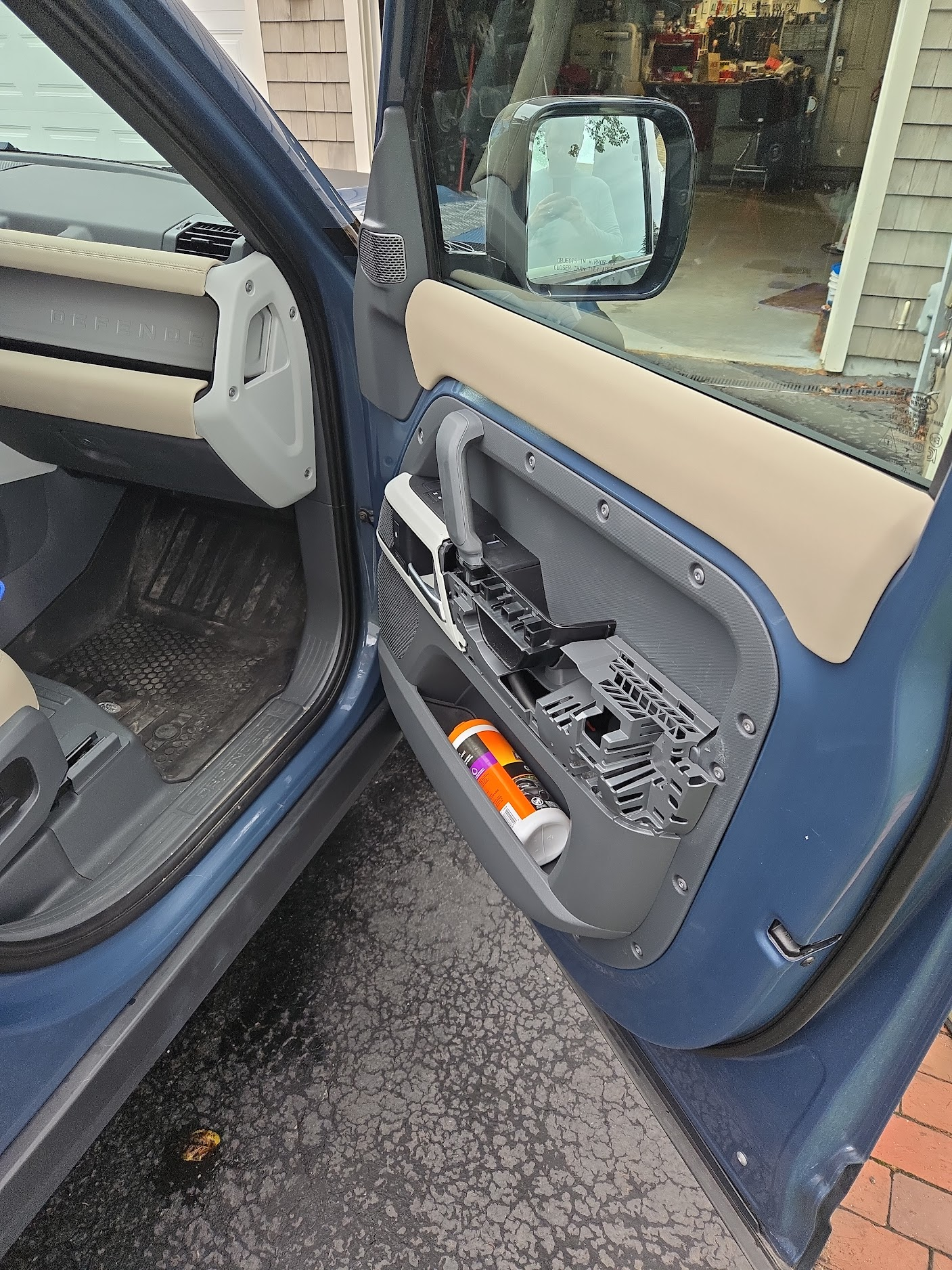

So I couldn't get it in to the dealer in time for our trip to NC coming up on Friday when we'll be driving for 16+ hours in the Defender. So I took another stab at it.
Got the panel off the correct way this time. Thanks again for pointing out my idiocy previously.
I lined the contact areas with interior Tesa (non-flammable!!!!) tape. Its not very sticky stuff but then it doesn't need to be. The contact point I think that was causing the squeaking was right under the handle. I had a little scrap of (new) shop rag on the top surface but I ended up not needing that - replaced it with another piece of Tesa tape. None of the tape is visible with the armrest reinstalled.
No more squeaky squeaky.
