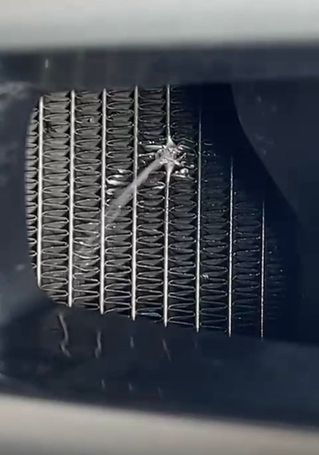

Dear all,
a 2022 defender hse400 owner. yesterday had a bad leak and found out that it was due to a stone hit. (i was traveling back to singapore from Malaysia). Picture attached to show the leak.
My question is, what are the odds of a stone hitting the aux radiator? I got really lucky? is there any guard or mesh that works for our defender?

Wow, must have been hot at high speed to pierce the radiator and cause it to leak. Glad you are safe though!

This is extremely common. I had to have one of my aux radiators replaced under warranty because there was a pinhole leak caused by a tiny stone that hit it too hard. In fact, they found over a hundred tiny stones in my aux radiator. Although it looks like you got hit with a rather large stone. Regardless, assuming you're still under warranty, this is a warranty replacement. This is one of the reasons why they removed one of the aux radiators on new builds.
