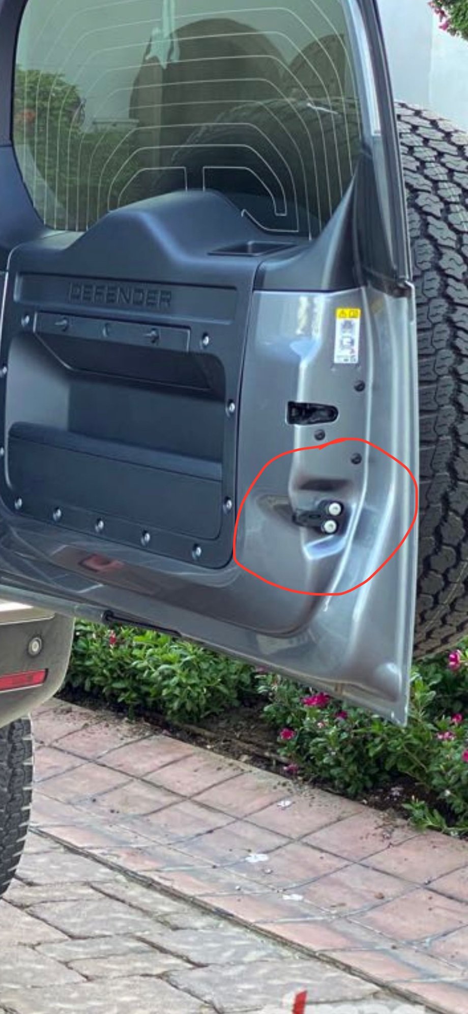

Sometimes interior noises reflect around the cabin and come from places least expected. One area that definitely produces ‘crackling’ and ‘clicking’ is the rear door guide that looks like a you know. This produces the noises over bumps etc. Some have noted adjusting it and some have used felt to successfully fix it. I used auto felt, lined the inside female that the guide goes into and all my crackling is gone. Try that out and if that doesn’t solve the issue then continue the hunt. When I heard it I swore it was coming from the headliner but after driving around with someone in the back it was narrowed down successfully to the rear door guide. Hope this might help you.
My 96 Discovery had the exact same issue and I'm expecting that the Defender will inevitably do this as well. In fact, the rear door on the Defender looks almost identical to the one on the original Disco. It makes me wonder if all doors that swing out like this are prone to becoming loose over time given the stress on the hinges due to the weight of the door and the spare.
