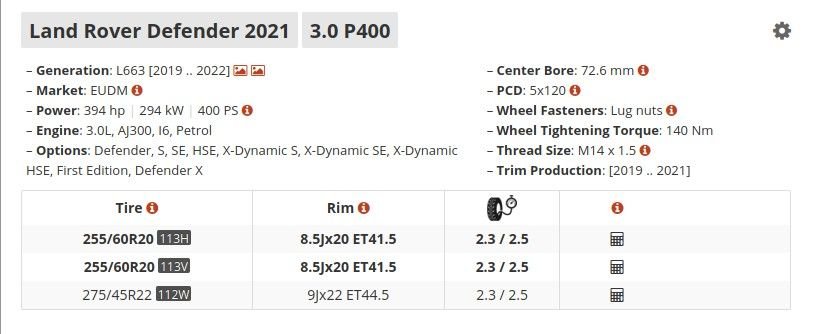

Can anyone confirm what the backspacing is on the STOCK 20" wheels?
I'm planning ahead for when (if) my Defender X ever gets built and delivered and considering options on aftermarket wheels. Did a search and only found info on what people were doing with their aftermarket wheels with lifts.

I found this site, and if their info is correct, for a stock 20" wheel on a Defender it's 8.5 x 20 with a 41.5mm positive offset.

Thanks! While it is showing for the European market (the site also shows Latin American market) and not the North American market, I'd think they would be the same.
Now I can try to determine if I can go with a little wider wheel (20x9.5 or 20x10) and change the offset to prevent interference.
