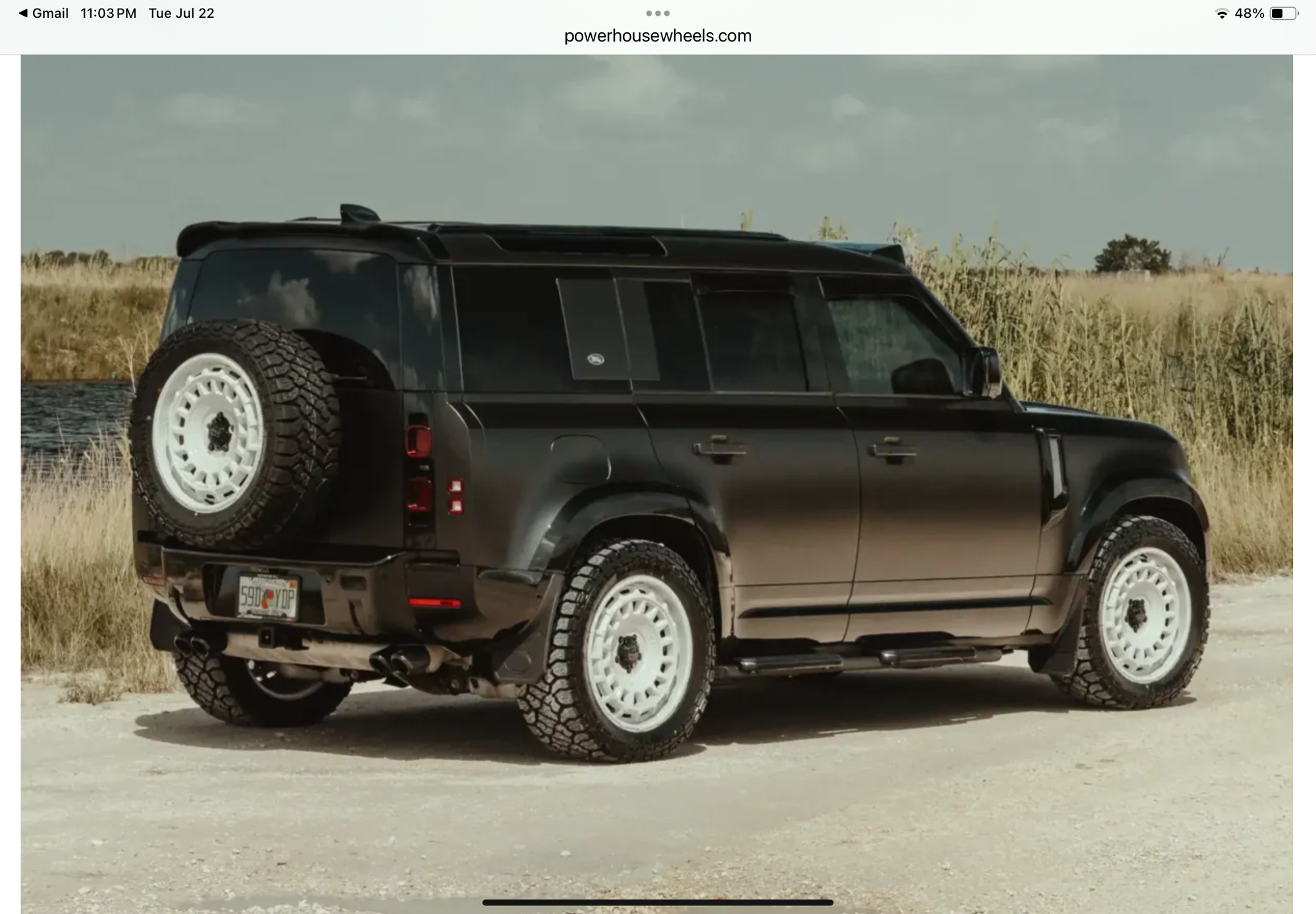

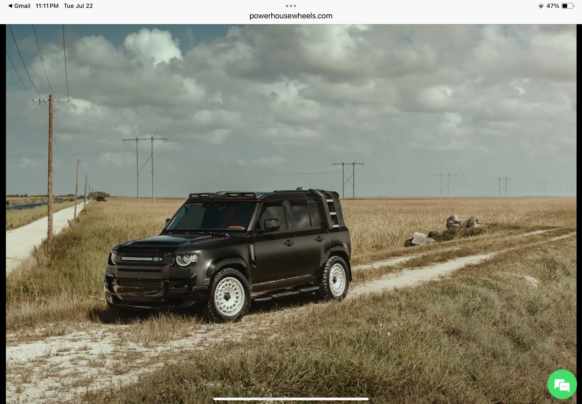

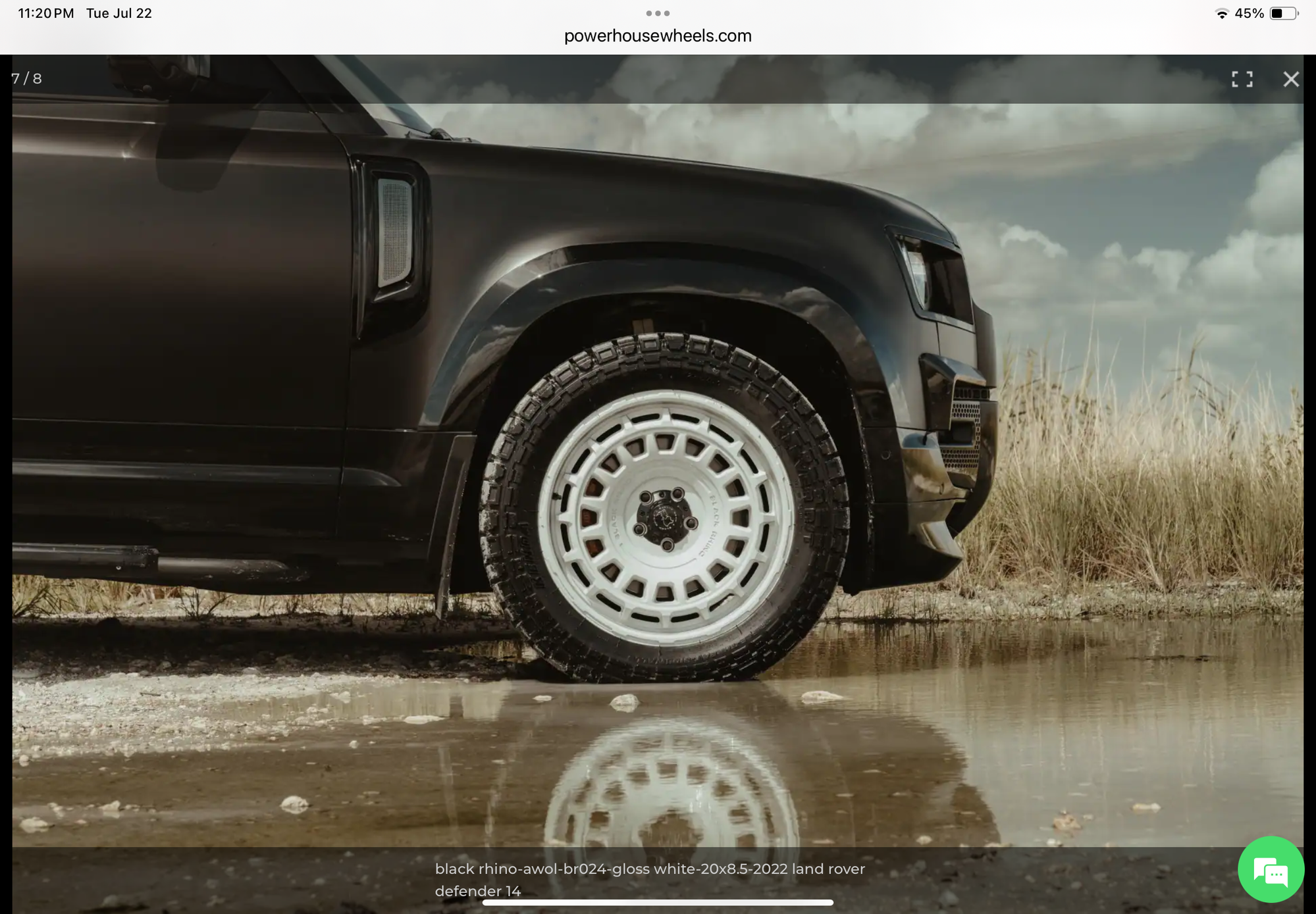

Anyone tried the Kenda Klever R/Ts? Killer looking tire. This Defender with them is gorgeous.
