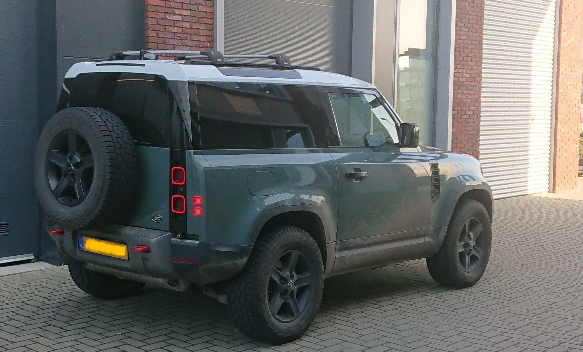

Noticed a while ago, maybe an ( early X-Dynamic ) design try out from JLR, but I think it looks rather good. Especially on the lighter colors.
You can save a black roof option by painting / wrapping only the arch.
So I did it, nothing to lose, easy reverting in case of...
Disassembled the 2 black corners,
Total of 4 M10 bolts under the arch.
Push upwards to release the metal clips from the arch.
Disassemble the 3rd breaklight with 10 Torx screws.
Have it wrapped locally in gloss black.
Everything in the same order re installed.
Result
Cheapest mod I did to my Defender...$ 25,- 😀

Nicely done! This is exactly I ordered mine (Hakuba) with a black roof. The back of this truck benefits so much from the contrast with lighter body colors and that arch.
