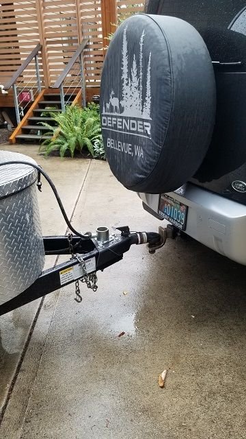

In my opinion,the most important detail of your towing setup is the shank length of your tow ball. LR says 7.5" maximum from pin to ball. I followed that advice, and have never had a single instance of trailer sway in about 15,000 miles of towing our TAB400 (like the OP @jgpell14). I realize that this can make for problems with opening the back door, a problem I solved by changing out the standard jack.
