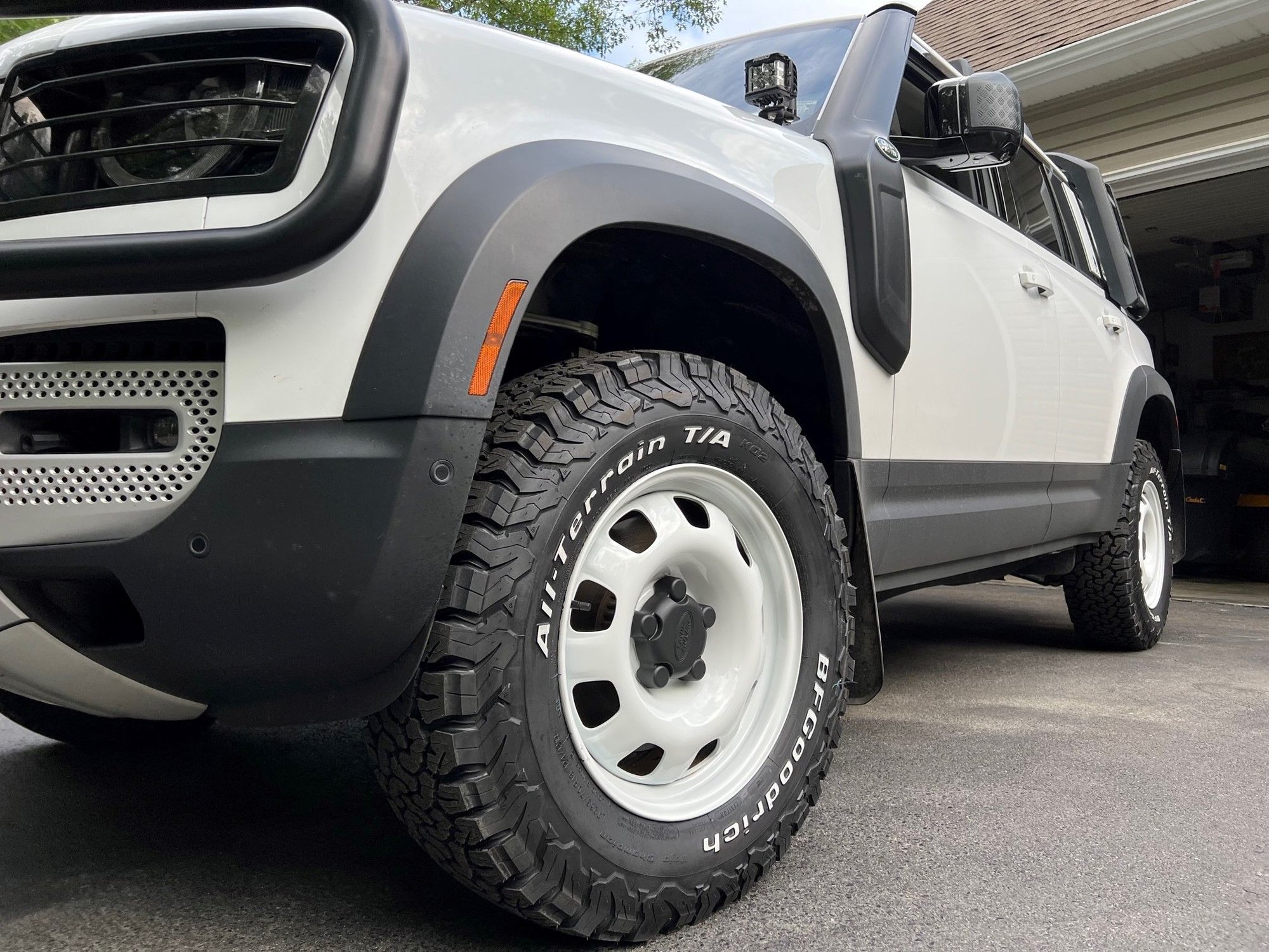

It's time to change the pads and rotors on my 2022 110 P300 S, and I could use some help/advise. I have done loads of other vehicles in the past.
It has the factory 18" steel wheels (I ordered it that way).
I already purchased OEM pads, rotors, brake pad wear sensors, and rotor retaining bolts for the brake job.
I'm confident I can get the fronts done. However, I am concerned about the rear electronic parking brake disengagement, as I don't have a JLR approved diagnostic equipment to activate the Integrated Power Brake assembly mode.
https://www.lrdefender.org/brake_dis..._disc-530.html
Any tips or procedures with the brake job would be appreciated.
