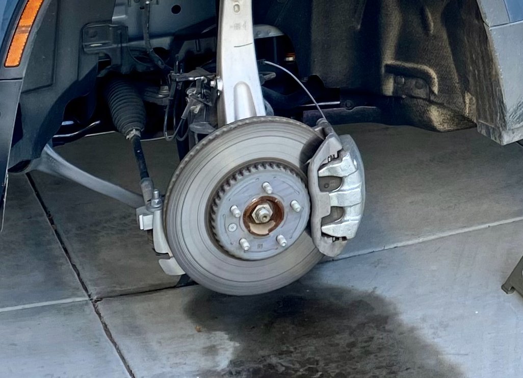

I'm not sure if my base p300 with twin piston sliding caliper front brakes are made by Brembo, but I do know that they are the lowest tier of the three front brake options available on the Defender -- the other two which are clearly Brembo-branded 4- or 6-piston calipers with varying sizes of discs depending on specs.
OP, I'm guessing you're referencing the same as mine:
I was just going by what one of my contacts at JLR in the UK told me. I have the same calipers and did some digging myself, and it looks like the two-pot front calipers are from ZF. I stand corrected
https://aftermarket.zf.com/en/catalo...9E/?country=GB
Part numbers are LR139157 for the left and LR139156 for the right.
ZF's part numbers are BHV849E and BHV848E respectively.
BHV849E is the ZF part number for the front right, and it appears that they have been discontinued according to ZF, which is maybe why you can no longer get 18" wheels from the factory. Although, the 18" wheel option is still available in Australia. Maybe JLR has enough calipers stocked up, similar to how they still have plenty of 5.0 V8s built up despite production ending nearly a year ago.
Regardless, the braking performance is still exceptional IMO.
