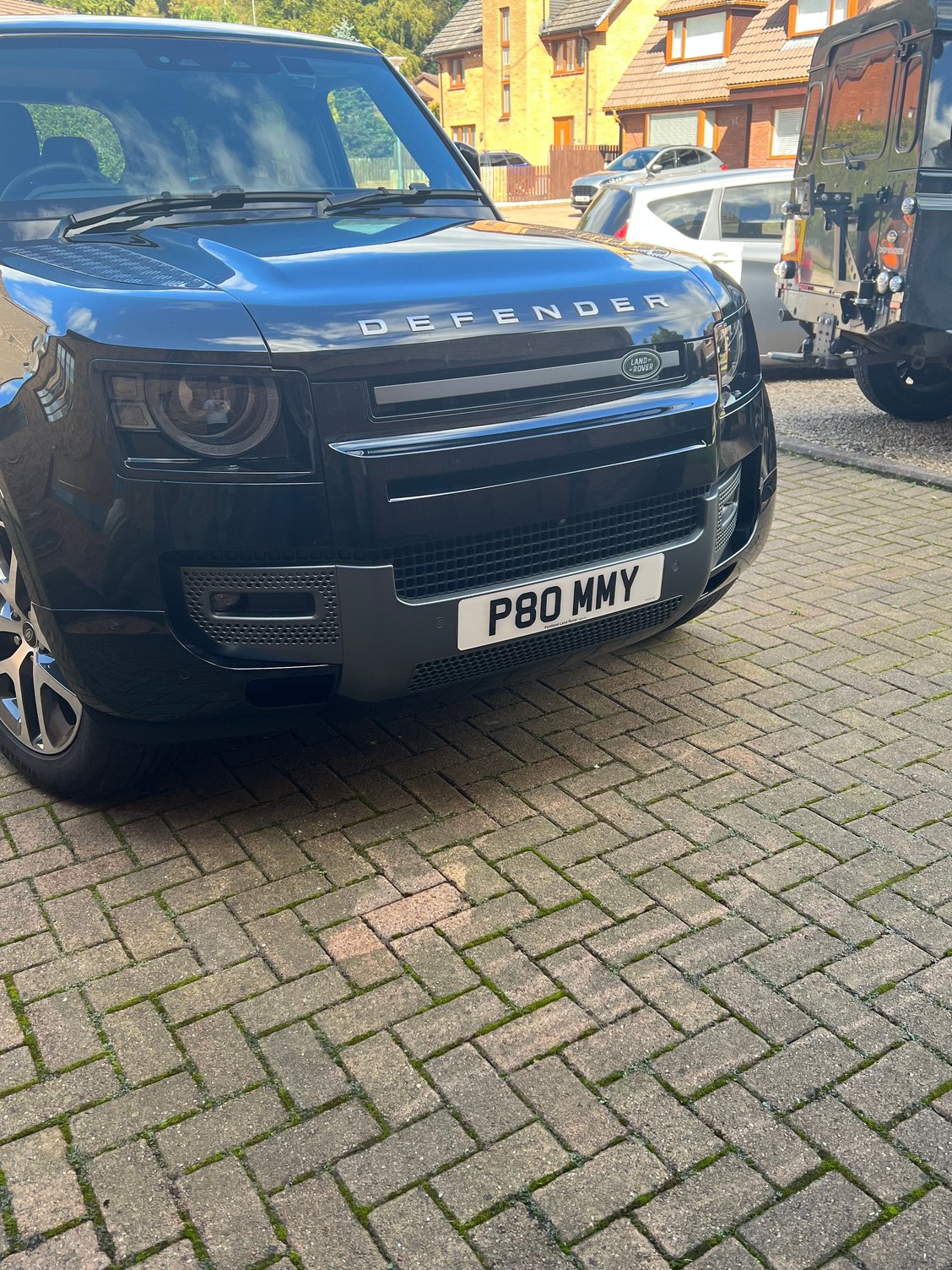

Has anyone painted over the brushed steel on the lower bumper? I am looking to mirror the color of my 110, but one auto shop said they dont think it would look good and wanted to order a new bumper in black instead... Thoughts?

Yes...I painted my front and rear silver bumpers black and it looks great. Very happy I did it.

We ended up painting the bumpers on the wife’s 110XS in Shadow Atlas as it was quicker and simpler than changing the bumper skins.

Yeah, we had the bumpers painted on the car, took our local bodyshop a day and a half to paint both bumpers and the sidesteps
